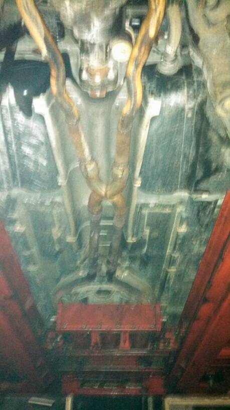

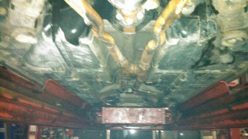

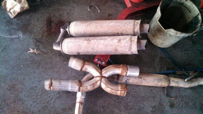

Reso delete, X-pipe added, about to be cat less (MIL eliminator), and 2.5" from manifolds back. I love the way the xpipe sounds.
