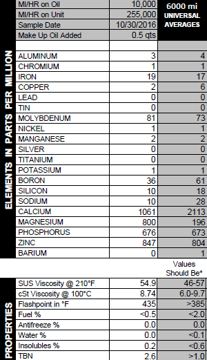

Finally got my oil report back. First one I did on the LS. I do them fairly regularly on my 3.5 Ecoboost Flex.
Left column is my 10K sample, right column is their 6K universal sample average. At almost double the miles of their sample averages, I still have less detectable elements. All except magnesium which I suspect is part of the additive in the Mobil 1 Extended Performance. I use 5W20 though if you live where its very cold a lot of the year, I'm sure a 0W20 is fine.
