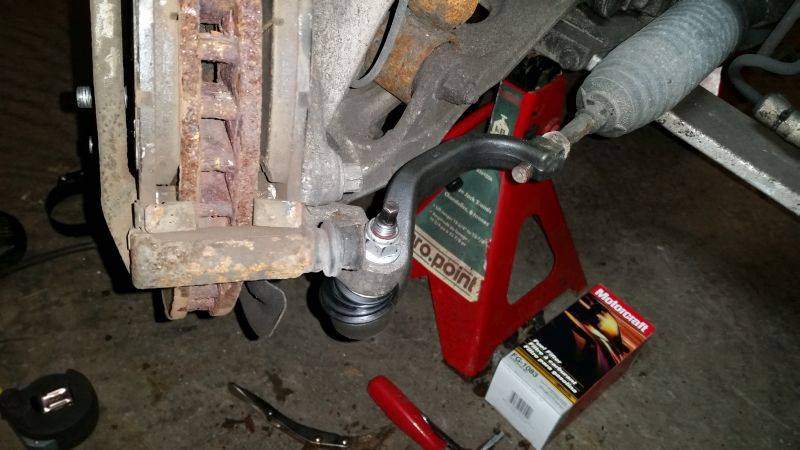

Got the front outer tie rods in. Pardon the nasty looking rotors.

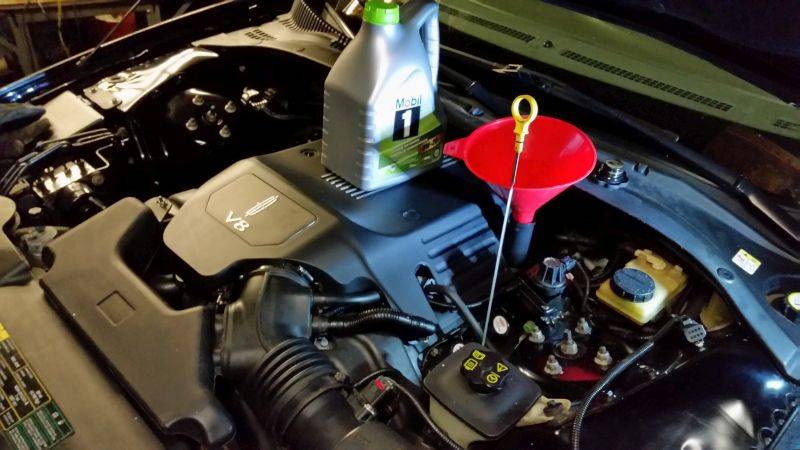

Fresh 0W20 oil w/ OEM filter

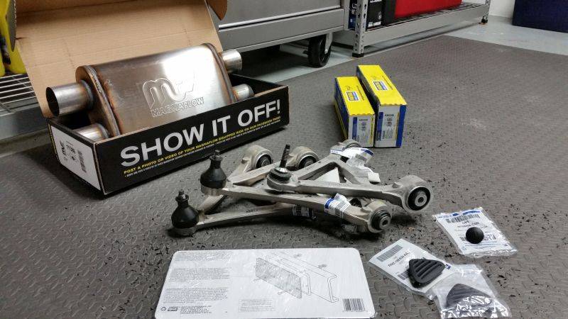

Got some parts in. Can't wait to get that exhaust done up.

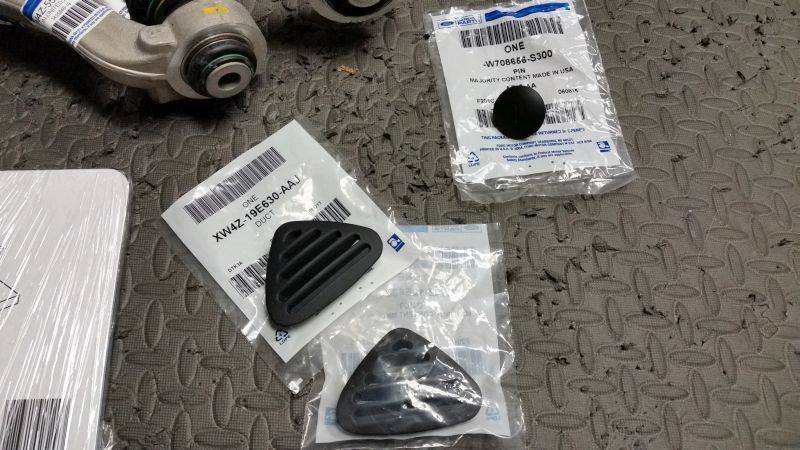

Some new vent ducts for my wife's 03 also new engine cover hold down pin for my 04

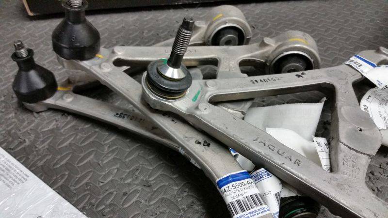

A few UCA's for both the 03 and 04, got all JAGUAR's from Tasca this time around. (received offset brands previous '01 order)

Changed out the fuel filter while doing the oil and tie rods.
Waiting on some rear toe adjust linkages to arrive. Have some rear swaybar end links to go in the 04

Nice pics/update. I just got my '06 and the front upper CA's have torn boots so I may be hitting you up for those part #'s shortly
