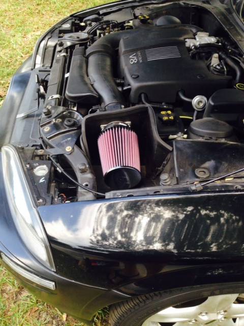

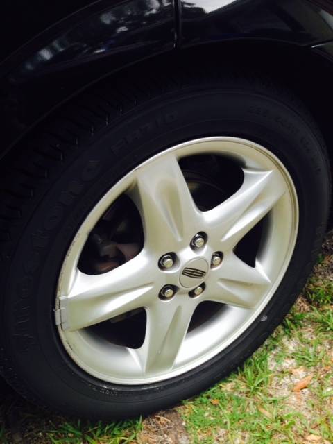

Well....on Saturday I installed the new K&N Filter, adapter and heat shield. Oil change. Plus New tires all around. Firestone FR710s.

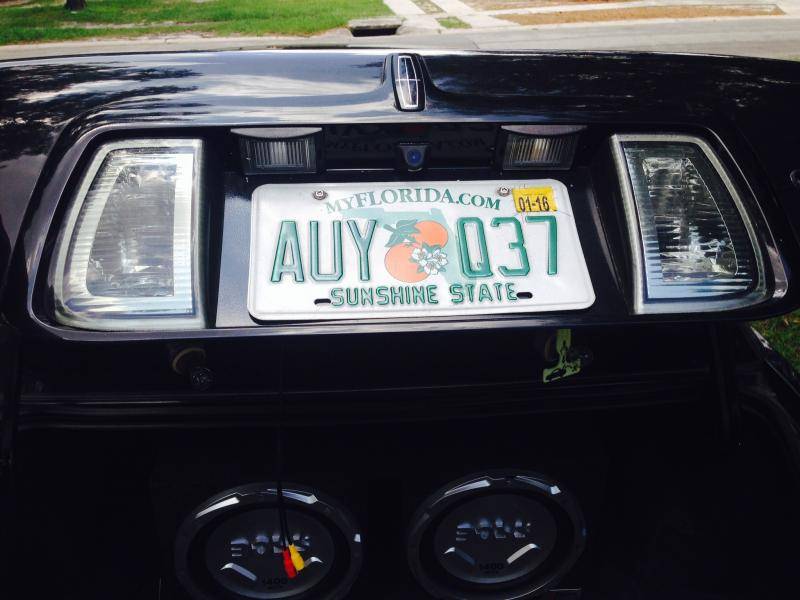

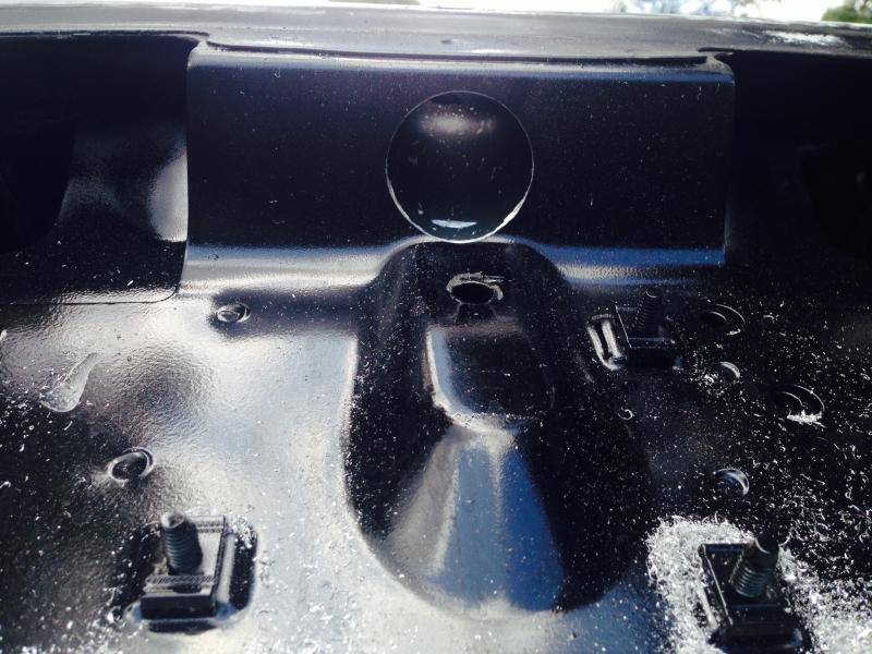

This coming weekend I'm hoping to get the back up cam finished. I'm scared about drilling into the rear surround and metal brace behind is what has really been stopping me. I have a ebony LSE rear surround, so I don't want to EFF it up. I have already run the video feed and REM wire from the radio to the trunk.
EDIT:
Here is the back up cam I am using....
http://www.amazon.com/gp/product/B00VUSVM8U?psc=1&redirect=true&ref_=oh_aui_detailpage_o00_s00

Any body shop men here can correct me, but I believe if you put a piece of masking tape over the spot you are drilling it will keep it from chipping out when you drill the hole. You can center it by finding the center of the license plate, then hang a string with a weight on it. The weight will pull the string taut, and the string will help you find the center easier. Start the hole with a much smaller drill bit than the part calls for, and this will give the correct sized bit a starting hole so it won't skip across. Start it slowly and you should be good. When it hits the metal, spray a little WD40 in the hole to lube the metal for the bit.
drilling the surround will be fine... its soft, the plate behind is more difficult. Remember the surround pulls out, the camera threads.wires go up... make sure the hole is big enough on that plate so you can still pull the surround off (if you ever need to) without needing to remove/uninstall the camera.

Drilled holes in the rear surround and the plate behind to install my back up cam. It wasn't as bad as i thought it would be. Went very smooth.
I'm really bad at wiring stuff so Joegr said he would draw me up a wiring diagram with relay to get it all completed.
