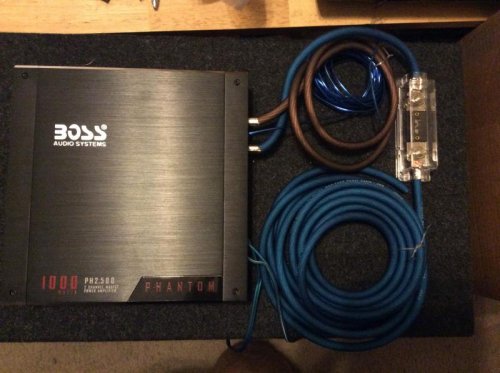

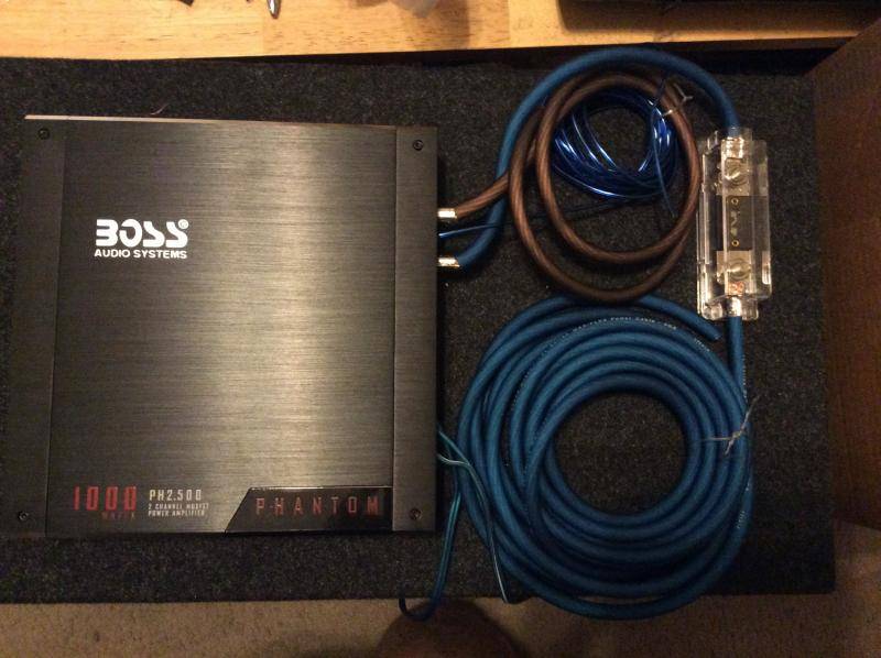

Got my amp attached to my box and all wires hooked up ready for my subs to come in. So technically I didn't do anything to the LS today. Just a bunch of prep work. Can't wait for the speakers to get here.
and all this time, I thought those fuses were a safety mechanism to protect the wire incase something bad happens...
Might as well not even have a fuse at all.
if the amp has two fuses in itself, what is the point of having another fuse five inches away?
fuses are always supposed to be at the power source, to do its job and be able to prevent a Car-B-Q, it should go next to the battery.
Precisely where I'm mounting it.
If the wire gets sliced open or worn down between the battery and fuse and makes contact with the body, you'll have an extraordinarily hot wire in no time at all that will get hotter and hotter. So will the battery because of it's rapid discharge. That wire will pull hundreds of amps and melt it's insulation, creating more short points. The fuse is meant to be mounted close to the battery to reduce the length of wire on which that is a possibility. Given the layout of the LS, I'd say mount it within the 5 inches it takes to reach the sheet metal. It's a fuse; it can float. There's nothing showy about a lack of safety until it goes up in flames, but that's the other kind of showy.
Sure, you could say "but it's all in the trunk. There's no real chance of the wire getting damaged" to which I would respond "It only takes one misguided knife or one carelessly placed item in the trunk to ruin a $5000+ car for 5 minutes of work"
It's not a big deal to move it. You'll just have to do it outside to get the right length
Yep, short that wire anywhere between the battery and the fuse and you will have an electrical fire.
Thanks......
I think everyone's concern is great. I really do. This picture is kind deceiving. The amp is mounted on the back of the box, not the top and it will be upside down when the box is sitting right side up. Also, I haven't trimmed the power wire yet until I get it in the trunk to cut the right amount. The box is going in sidways in the trunk. Where the fuse is located the wire will drop right down to the battery. It will be the same length on both ends of the fuse.
IF, I get it all in the trunk and I don't like the setup I can switch it around. This is what I want to see before I cut the power wire down. I have installed these set ups in my previous vehicles. I have always had the battery in the front of the car which is where I have always placed the fuse. With the exception of my 95 Buick Rivieras, where the battery is under the back seat. Then the fuse went under the back seat with the battery.
First time where the battery is in the trunk. So we will see how it goes. :)

there is so much room right next to the battery why not put it right there. I mean its a fuse that hopefully you don't have to replace any time soon so being able to reach it easily is not a huge issue.
so your excuse to doing something wrong and dangerous is what again?
just seems silly to do something incorrectly for absolutely no positive gain.
it doesnt matter how short that wire is, the fact that the fuse is in the wrong place makes it useless. again why even have it there if your amp has its own fuses.
also, think about this, those fuse holders were NEVER designed to be mounted to a sub box, there is a sh!t ton more vibrations there, so what happens if that set screw loosens up enough for that power wire to fall out? its gonna short and the arc could very well catch your car on fire...
why even risk it? whats the pay off? are you just trying to show it off and look cool, cause there are two types of people, the first is kids that don't have a clue what's what so you could literally wrap wires around a big turd and they would think its cool, then there are the people that actually know what's going on, and every one of them will just laugh (probably just to themselves) the second they see it, either way, no street cred will be given out.
I guess I am also confused as to why you would do it correctly many time before and then just not care this time, is your LS really that big of a piece of sh!t that there is just no fukcs left to give?
Izzy, just put the fuse under the cover and make us happy. It'll give you a nice, discrete power point for anything you want to add later, like additional trunk lights or a permanent USB port for charging something while you're away from the car.
Thats probably where it will end up anyways. I was looking at the trunk during my lunch break and I realized that I would have to move the box anytime I wanted to get at the battery or if i need to change the tire. **knock on wood**
So we will see. Thanks LSFrank. :)
