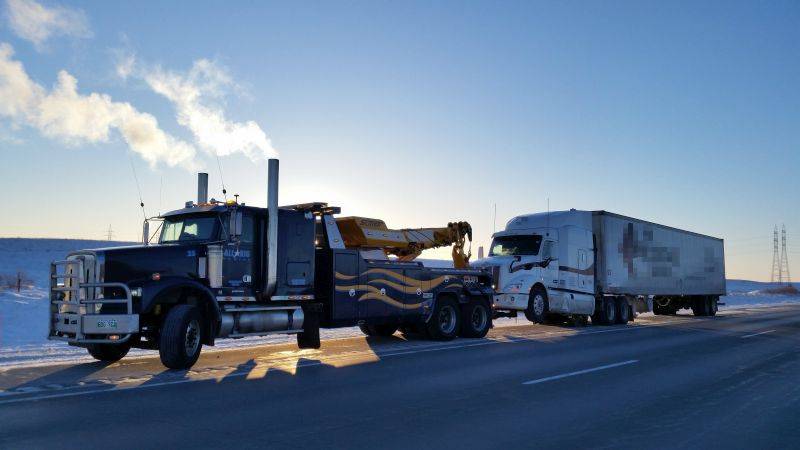

So last weeks trip was a blast ... on top of a clean level 3 MTO (DOT) inspection on route, I get to within 42kms of my weekly destination and this loaner (mine in the shop for loss of power, low manifold pressure, leaking turbo), decides the tank to tank sending unit needs to go bad and shuts down on me as one tank ran dry and sucked air. -34C had something to do with it also.
First time on the hook ever for me. They put me up in a hotel for the day.

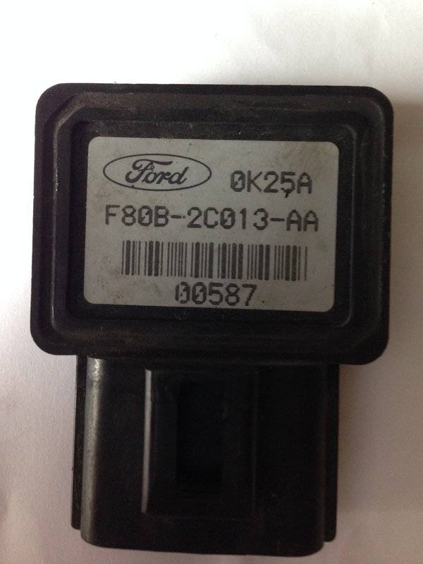

Help! This is smog pump relay for Lincoln LS 2001 V6. Ford do not produce them anymore! Dealer dont have it too! I have a service light and cannot pass an inspection. Some junk yards have them but with different short numbers on the top and bottom. I dont know what do they mean, these numbers.
f80b-2c013-aa is the part number, the other numbers shouldn't be a factor. It looks like yours is missing the mounting ears/heatsink.
It was torn of in the accident. A lot of the same relays have the same number but different two others. That is make me scare to buy them and they do not have suggestion charts where they can be used beside stated. like, this is an ABS module but can be used also for...etc.

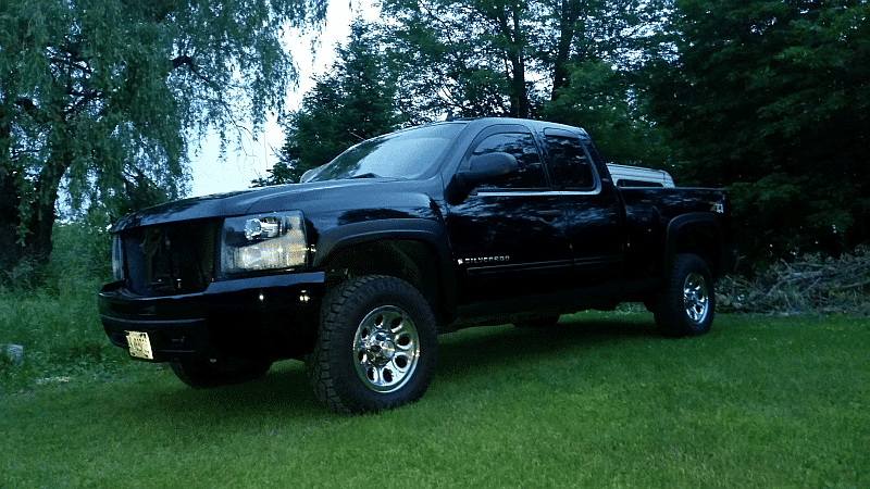

Finally got a chance to try out my new TORQ 10FX orbital.
Brought my '09 Chevyrado to a near mint perfect shine.
Pass 1. ~ Meguiars Ultimate Compound using Yellow HEX-Logic Heavy cutting pad.
Pass 2. ~ Collinite No. 845 Insulator Wax using Red HEX-Logic Ultra Finishing pad.
Pass 3. ~ Micro-towel using elbow grease.
Very happy with results, took out pretty near all light scratches, hard water stains and swirl marks.
Need to clean all glass in/out and touch up all molding using Mothers' Back-to-Black.
Sore lower back at end of evening though ... :( ... No pain, no gain.
