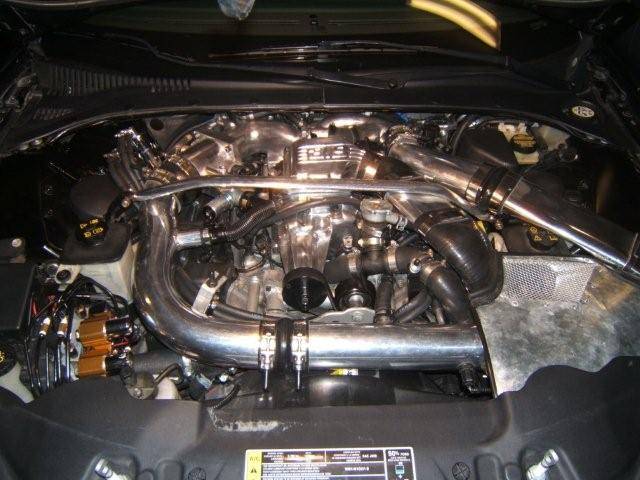

I have mine steamed. Then just keep it clean with Simple Green.
Show off!!!!! But hey that looks really sweet!!

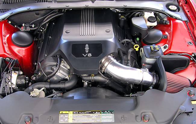

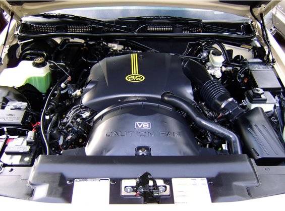

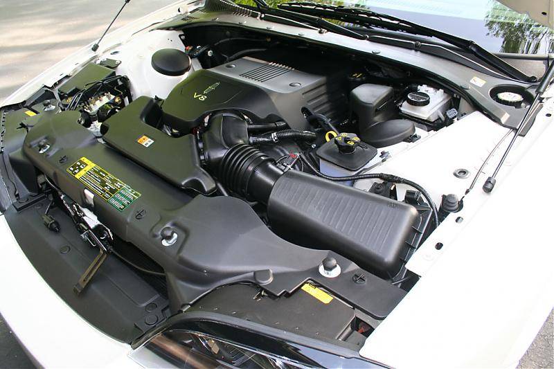

dRock, Quick, Tman, all kicka$$ underhood shots. I really like the red/black contrast on Tman's ride.
Clean looking engines there, guys. You've inspired me to polish mine up! :D Hopefully after this crummy weather dissipates.
