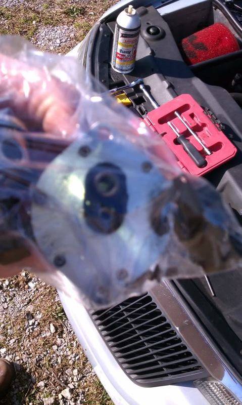

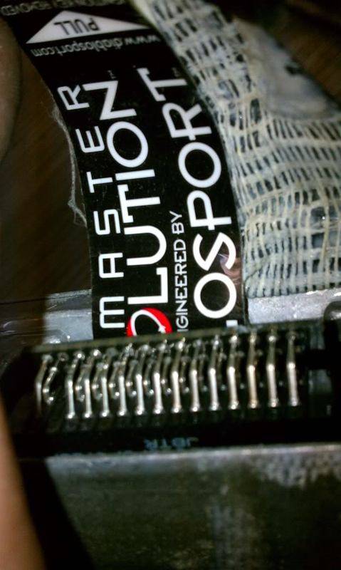

Today I had to run up to the shop and grab the 98 cobra intake i sold :( . decided to go steal some parts off of the 95 that i have. as it is stuck on the lift. i had already put the cai on the 93. decided to give the chipped/dyno tuned computer a shot. HOLEY SH!T it is a completely different bird. the shifts are RIGHT NOW. there is a power gain that is noticeable 2-4k and then all hell brakes loose past 4500+rpm. it shifts about 500 rpm higher and with the jmod and pressure increase it shifts faster than any auto i have ever been in. and i had the w3z2.

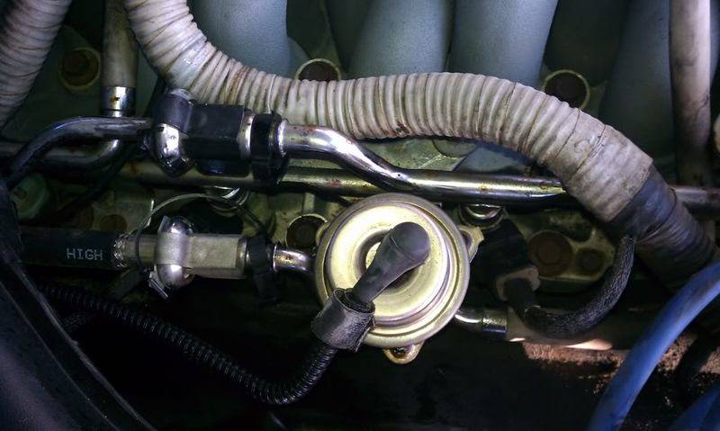

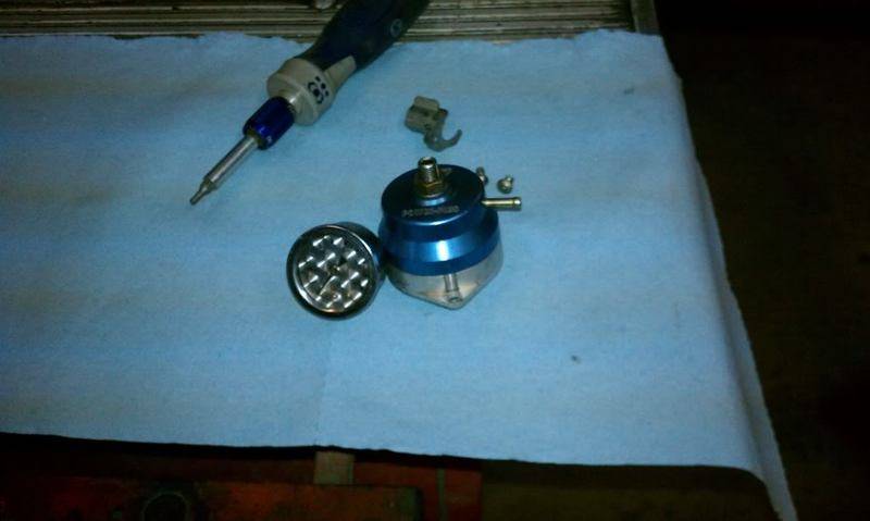

i wanted to put the adjustable fpr on it but the rail on the 93 is not the same as the 95 or the 98. the 93 has 3 screws and the 98,95 and my spare rail has 2. seeing as i do not have new injector seals and o rings laying around. decided to wait until i am properly prepared. so i just snatched the corner lenses and upper valance cover.
i can not wait to put the kooks, under drive pulleys, and my loaded 373 with trac loc diff in it. you can tell the car is not quite shifting perfectly with the old 307s in it. and if you dont feather it it just boils the one tire off of it.

If you want to use that FPR just swap fuel rails. Mine is a 93 which should have 2 bolt but engine is a 94 so I have the 3 bolt FPR. I was like WTF till I found out it has a 94 engine.

my 93 has the 3 bolt FPR as well. but i don't think its a big deal just to change fuel rails if you really want the AFPR as ROTM said.

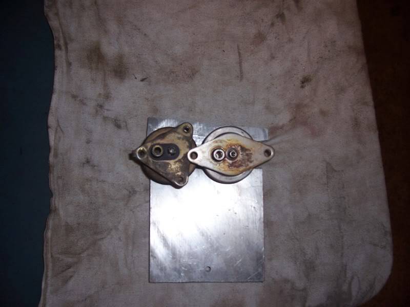

i am going to, i just want to have o rings and injector seals on hand. so i dont go up in flames like that guy did a few years ago. and it is the other way arround the 93 has 3 holes the 98 95 and 96 cobra rails have 2
this is the 95
this is the 93

Ok I got it backwards! I know I could not steal the FPR off my 90 mustang because 2-3 bolt pattern was different. Got a kirban for 75 bucks thou good deal.
