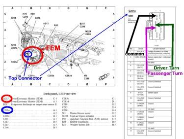

Can someone clarify? Just tap into these two FEM wires and good to go? In Quiks V LED instruction he says ground to car... won't I end up having constant power to the turn signals?
Three FEM wires, as shown in post #7.
"Common" is the positive wire. It will be at 12V all the time that the car is awake. The two labeled turn signal wires are the switched grounds to the signal bulbs/LEDs.
(I can't actually make out which three wires he identified, but I assume shows the correct ones.)
PS: I don't see anywhere in this thread where Quick says anything about "ground to car."
Thanks joe gonna give it a try. Was referring to this thread under step 4
