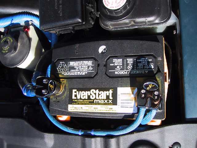

How hard a job is it to change out the battery wires & terminals?
The battery terminals just need to be unbolted from the frame, block, battery, and fuse box and starter (good luck with the one on the block).
The terminals are easy and may I recommend an upgrade:
