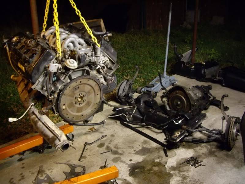

Can someone tell me where they are located and whats needed to.change them ?
They're under the intake.

I agree but there a lot of engine parts that were placed in not so good locations in the Mark. It's just never thought about until one of those said parts ends up going bad and needs to be changed for new.

In order to monitor the engine for knocking (detonation), they must be mounted in the block walls, as near to the cylinders as possible. The only other possible location would be on the outside of the block, a location that Ford tried in earlier engines, and found to be less effective.
