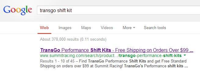

https://www.google.com/search?lr=&h....348.3j1.4.0...0.0...1c.1.17.serp.GfZvkmc-FRE

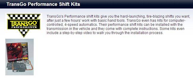

If it were my LS I would change the shift solenoid, put in a transgo shift kit while the pan is off, change the filter, fill it up then take it to the dealer for a flush. If that doesnt cure the problem then you are up a creek

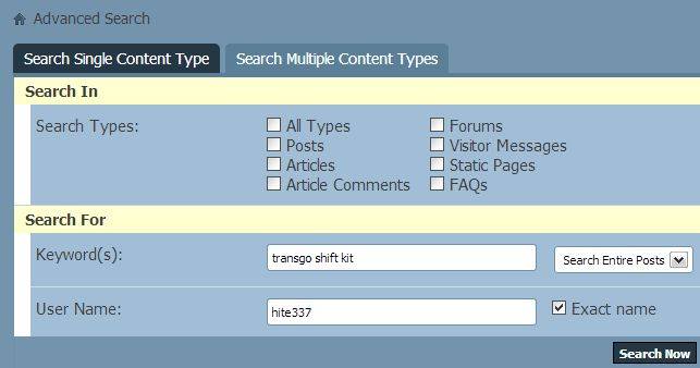

Just spoon feeding, guess the search function must be broken again, logic seems to have gone for lunch as well.

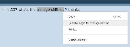

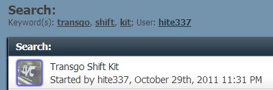

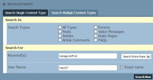

bigrig i ve searched for and i found it but thanks for yr help yr answer
