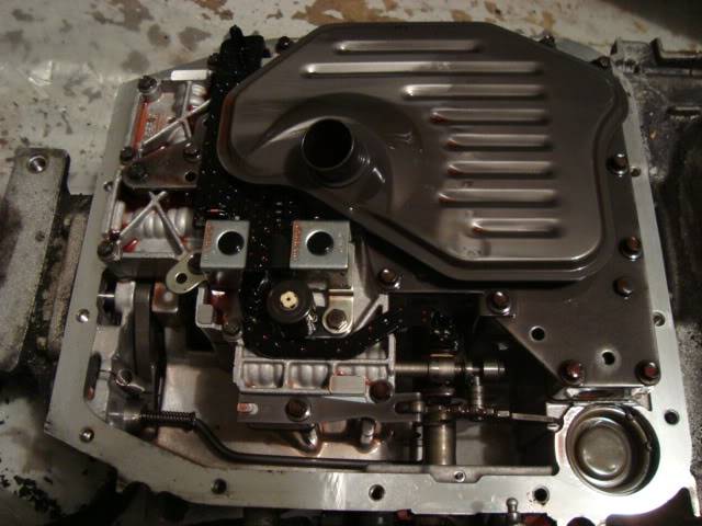

Im getting a tranny shudder while taking off from a dead stop...usually happens after an hour of driving. The tranny shifts really good any suggestions? It has new filter with Mercon V in it. Its a 97 transmission I havent done the 1-2 accumulators on it yet.
Go to Napa or AZ and find some Dr. Tranny and give that a try. If you do not have your 1-2 & 2-3 updated accumulators, then I would suggest getting them, especially the 1-2 and if your springs are not broke, then no need to waste the money on new ones. Just the accumulator upgrade will make things better or at least help anyway.
Bottom right hand corner is where the 1-2 is. Press it in with a screwdriver handle or the like, remove the C-clip and then let the accumulator drop down slowly. It is spring loaded and fluid will come out of the hole so keep the face back out of the way. Replace with new one and springs, your option and most do get new springs but they ain't cheap. One is purple and one is blue. Put them back where they go and get the accumulator in place and press it up in the hole and then put your clip back in. Done deal.
