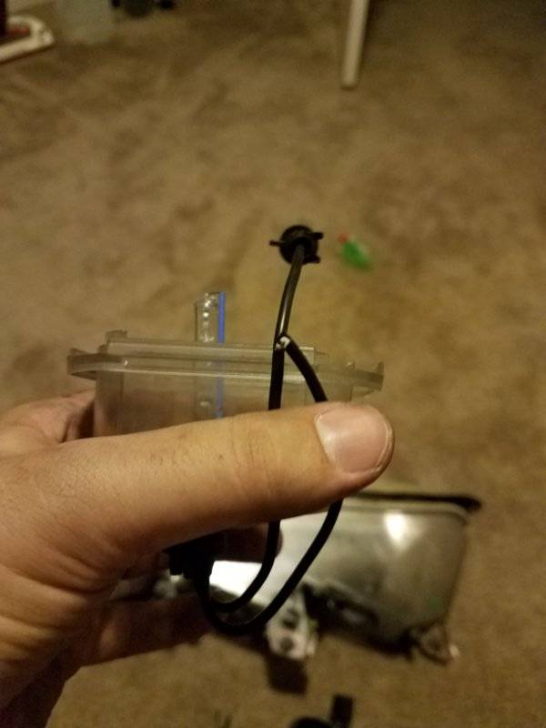

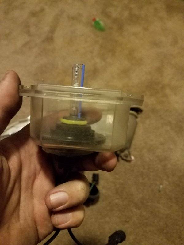

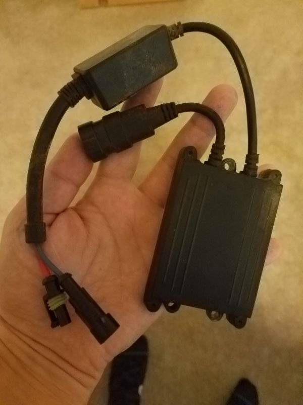

Look get a bulb that looks like this and a ballast like this and follow the directions on that car domain link i posted earlier and you'll be good to go legality aside you will at least be able to see at night i'm unfamiliar with ford as a whole and i only just got our mark viii in may but i've been wrenching on cars since i was about 13 years old this is as much help as i can provide right now i'll be able to take better pictures once I get paid at the beginning of next month when I order an ebay header panel to properly mount the new to me headlight assembly its held in by zipties and prayers and I'm all out of zipties otherwise I'd take better pictures for you right now

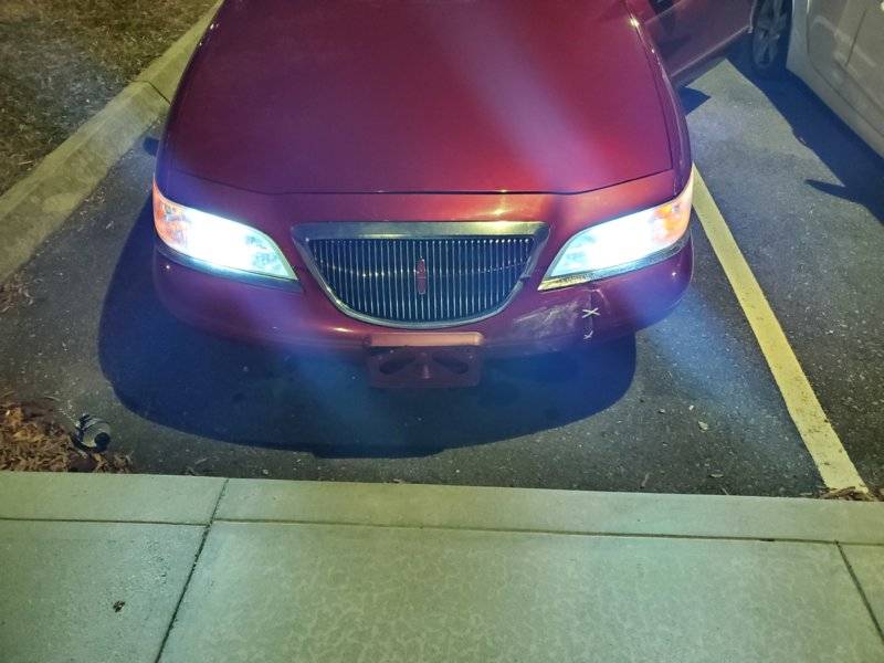

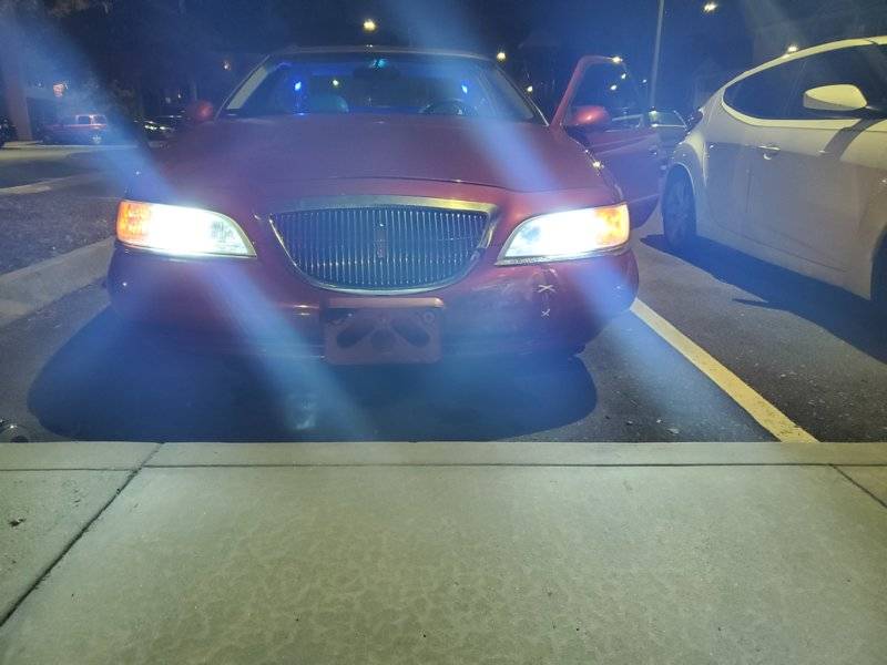

Post pictures too like this is what ours looks like at night granted they aren't the best images

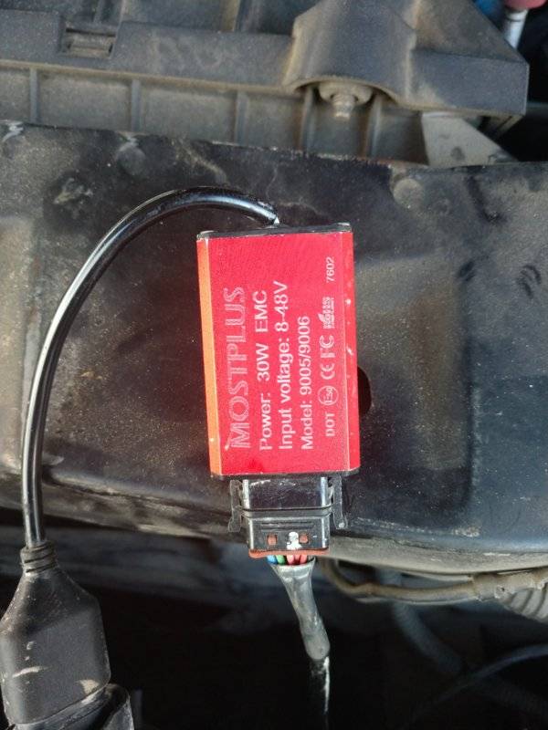

Hello, I recently purchased a set of "Stark" LED bulbs for my 95 Mark VIII. They are a 3 sided bulb with the fan at the base, they work great! But a error message "check exterior lights"displays on the DIC when I turn on the lights. I push the reset button, error message goes away, I repeat this action Every time I turn on the lights. My autolamp function is inoperable, I have to manually turn on my headlights, I would appreciate any information as to why they do not function. Do I need a new headlight sensor? Thank you for reading.
Put a 5-Ohm Resistor on the Bulbs positive wire

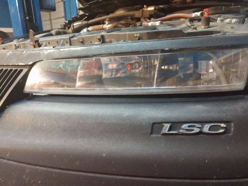

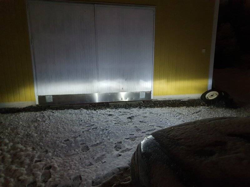

Here's pictures of IPF LED in my 95.
It is a fully plug and play, no wiring like the HID and control modules or such.
Just like replacing any HB3 bulb, and I didn't even need to clock the LED filaments as they were spot on from factory.
Cost? A LOT. I paid equivalent of $250 for my two low beam bulbs.
Worth it?
Every single penny.
Now I can see. Before I could not.
Is it good? Yes. Great? I wouldn't say that.
It's no Xenon projector headlight, and it will also never ever be that.
But it's good enough for what it is, a useless headlight housing.
I have more light exactly everywhere and the width is amazing.
The length, not much of a difference.
But this definitely beats cutting the wiring, cutting the housing etc to mount a china made projector.
Total light output on low beam is greater than stock Halogen high beam, tho the high beams have longer light throw.
I will upgrade high beams to LED aswell but no $250 IPF. I'll stick to something around $150 as it is good enough for high beams. The low beams are the important light.

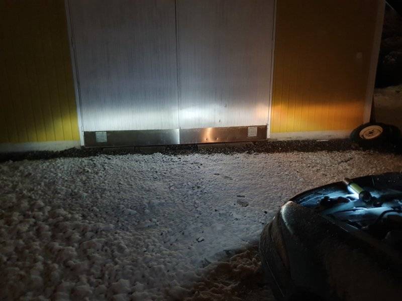

Stock Sylvania Halogen
IPF LED on the left, Sylvania Halogen on the right

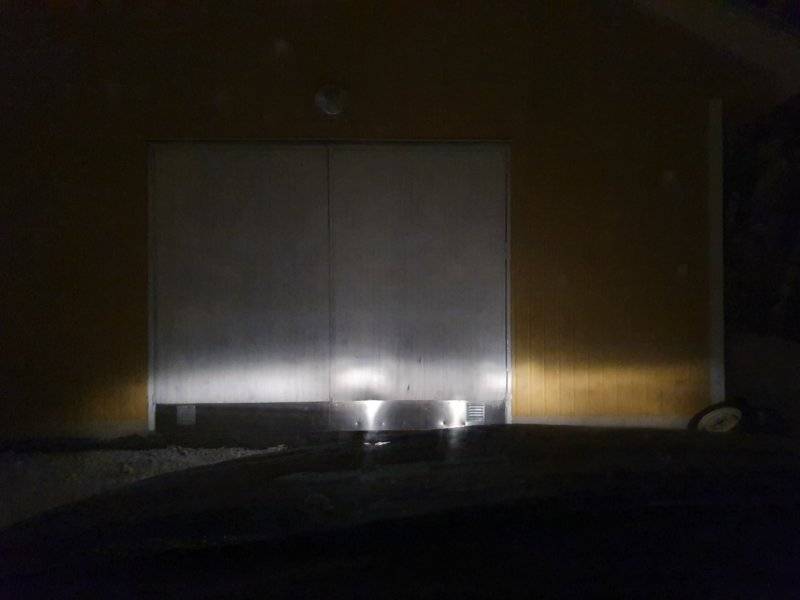

Both bulbs LED

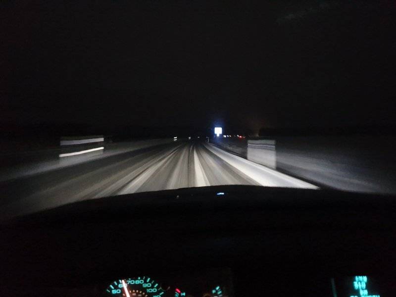

A pretty useless pic of the light while driving.
This one is of the garbage HIDs currently in the car, I'm saving up for a set of morimoto elite 35w.

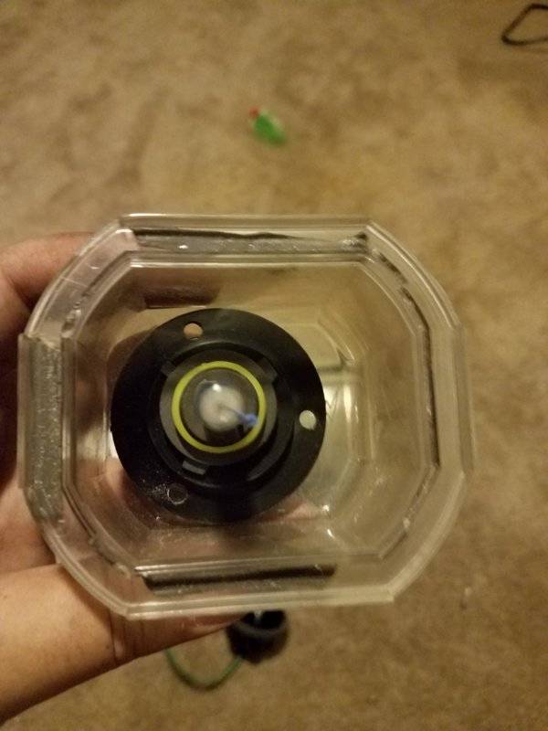

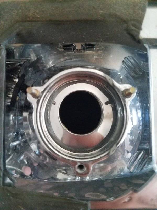

Bullymong88, you just so happen to have the adapter rings that Jay made, and still might be making. They're needed for Gen 2 Marks. 9006 bulbs. I have HID's in my low and high beams. Been working for over a decade now. Some like 35 watt and some like the 55 watt kits. Neither one will burn the housing chrome. They don't produce enough heat. Go through the link above and you'll find Jay's username 98lsclin..... can't remember it but he was also a member of the Facebook site named "Lincoln Mark VIII Enthusiast Community", if it's still on there. I quit FB back in 2015 but his name is Jay and he can be trusted. I believe he lives in North or South Carolina
Nolimit95 I assumed they might have been aftermarket but wasn't sure, one of these days I'm gonna get a 3D printer and make them too its not a complicated adapter its quite clever really. I assumed the 55 watt might melt the plastic I hadn't even considered the chrome melting, I noticed today when I put tiny auxito leds in the brake light that the plastic in the reverse light is bubbling really bad so I'll have to put dimmer ones in place there, sorry off topic.
A lot of the guys went with the 55 watt and none ever experienced the plastic melting. This even goes for the Gen 1 housings, which are smaller and closer to the plastic. Gen 1's originally came with 65 watt halogens, which produce too much heat and they eventually burned the inner chrome. I went with 35 watt as soon as I bought both new housings and like I said, this has been 10-11 years ago. They're still crystal clear and no inner burn inside. Kensun was the brand I went with for both sets. No adapters required for Gen 1, unless they were the clear HID housings. The low beam in that case would need to be 9006 and high beam 9005. Mine are halogen housings which take 9005 in high and low. I know you don't need the adapter rings but some on here do. Jay used to sell them on eBay. They're made from Derlin. Anyway, that link will help others understand what they're getting into, especially for Gen 2's, but it is worth the swap. Even if one blows, it's super cheap to replace, or even have a spare pair on hand. 5K or 6K are brightest. I like the 6K best but everyone is different. 4300 suck IMO because to me, it looks like factory color. As for the LED's, I've never tried them. I'm just of the opinion, "if it ain't broke, don't fix it". Nice talking with all of you.
I provided a link way earlier in the thread to a cardomain post which showed op a step by step how to on how to replace the headlights but that's when I thought the delrin adapter came with the car, eventually I'm gonna get a set of morimoto elite 35w hids and call it a day and I totally agree 6000k is the best I used to say 5000k but that's before I saw a good 6000k
