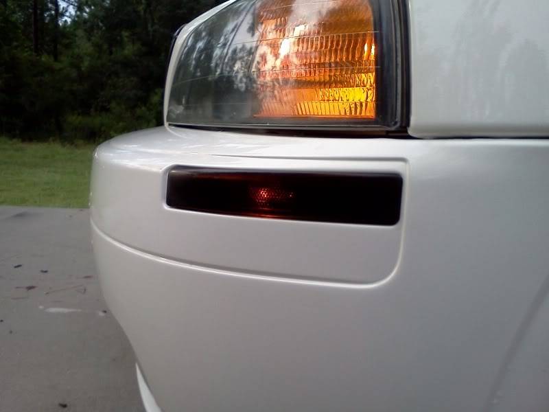

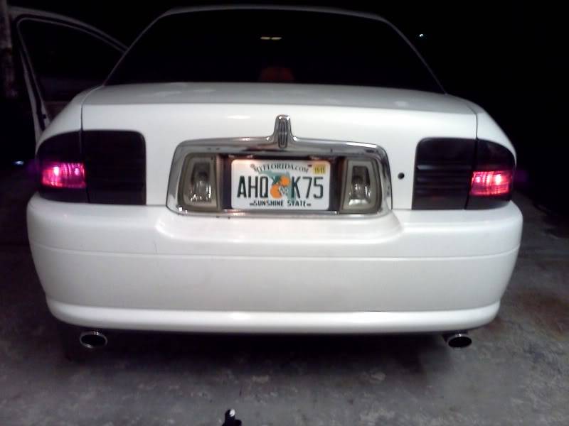

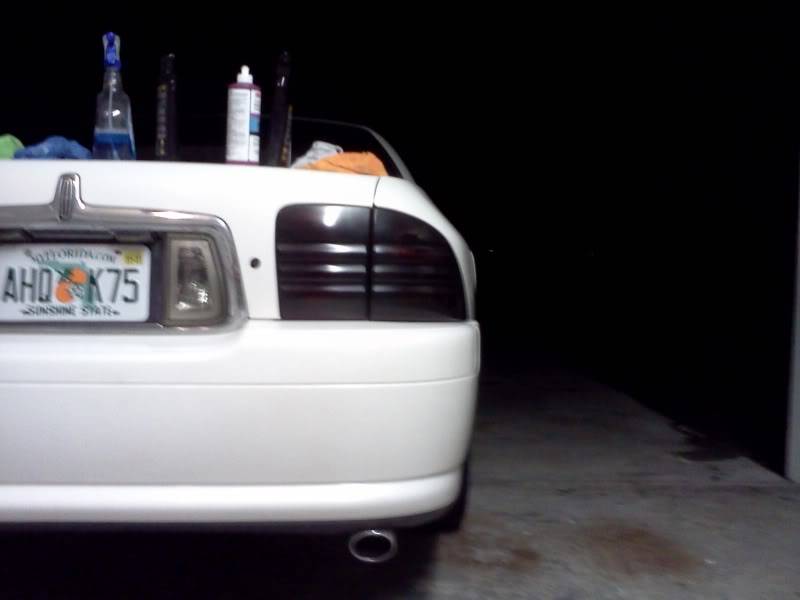

Tinted the tail lights on my car today.
And let me tell you..
What a B*tch..

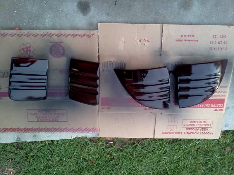

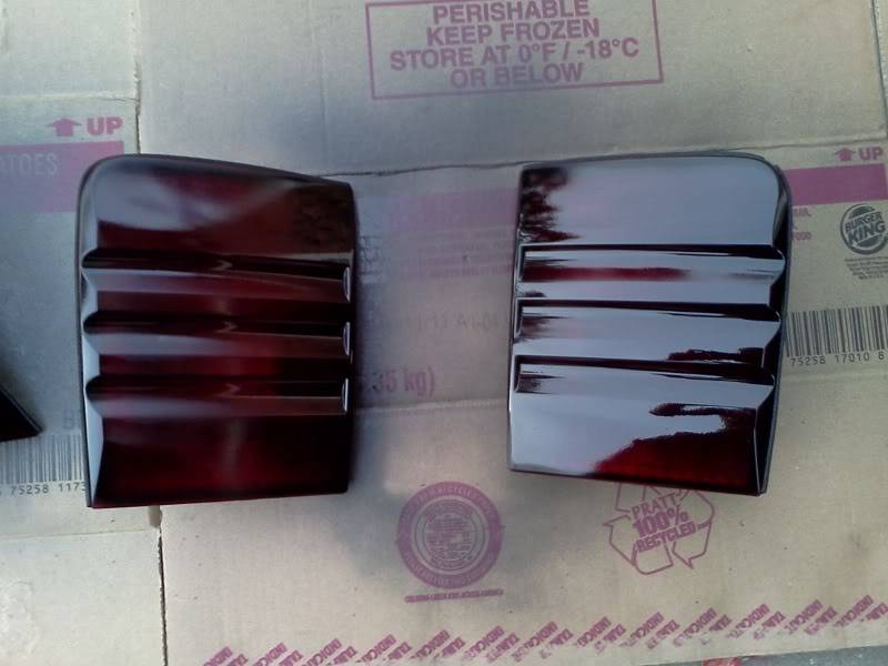

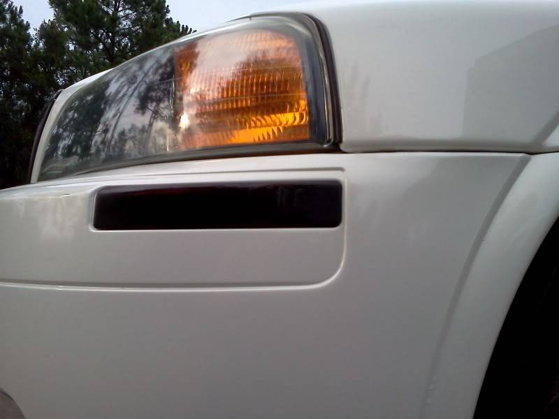

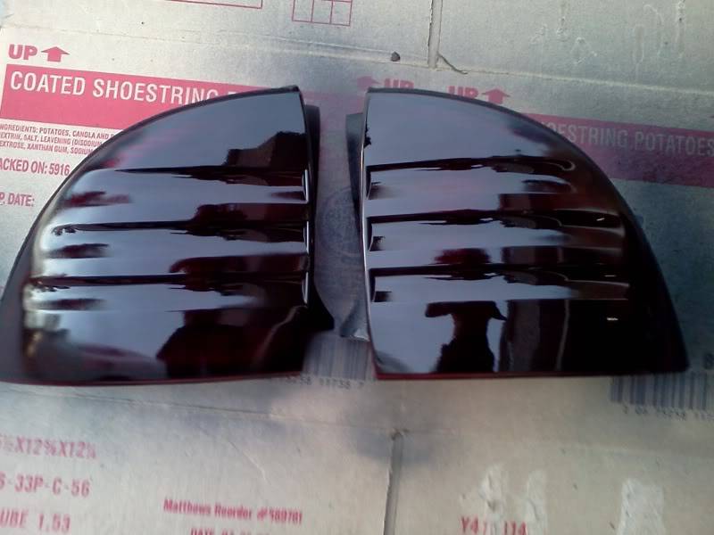

I followed peoples techniques on the VHT Nite Shade product.
I Sanded the tails and Side markers with 1000 to 1500 to 2000, then sprayed on the Nite Shade. I say It looked pretty good just had some orange peel. So I was like ok Time to wet sand again, 1500 to 2000 to 2500. Then used some Ultimate Compound.. And it looked like arse.. There was no gloss whats so ever.. I tried Machine buffing the tail light.. Wow what a failure, had to respray that one because it ate away the tint. So then I cam to the conclusion that I couldnt use a compound to get rid of the Hazy or matte looking finish.. So I saied hey.. what the heck.. Let me spray em one more time and let em sit after wet sanding it..
Tryed it and hey.. look a gloss and a almost smooth finish.
So 5 hours later of Sanding, Buffing, Removing and Installing both the side markers and the Tails they are done.

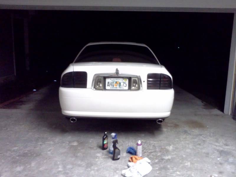

They are by no means AMAZING, but.. they get the job done. Not really digging how dark they are but Itll grow on me.

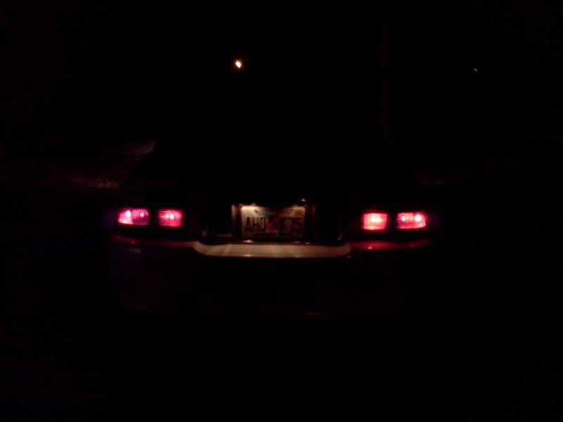

Light shines threw it as though they wernt tinted so Police I dont think will have a problem.
Tell me your thoughts.

looks good man, makes it look a lot more aggressive. Used vht on my tails and it was a bitch to get them shinny and I still have some perfecting to do just to lazy to get to it lol. I put a lot of clear coat and then buffed and that seemed to work the best for me.
Stands out a lot on white.
Looks cool but i like the two tone look on mine.
Looks good! I had a friend do the same thing on his 100% blacked out LS.
Thanks buddy, Yeah.. its probabley bad that I havent used Clear coat yet..
Later this week or so ima buy some clear and take em out and clear em.
question is, Do i need to Wet sand em again to clear or leave em the way they are.
I just cleaned really good and put the clear on, never wet sanded mine and they turned out good, did the same with my headlights. I used dupli-color clear from auto zone, I tried some stuff from some other brand and it was crap so pick a good one.

Lose the chrome surround and it will look a lot better I think.
But still looks good regardless
I went into the project not wanting them to be dark at all just smoked a little.
BUT Ended up doing it too dark. Oh well. It kinda gives it a mean look imo
For a lighter finish, just wet sand evenly until you reached the desired tint. Then shoot two coats of clear and they will shine hard.

I concur what Slick said. Sand it lightly and you will lighten it up and make it smoother.
