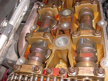

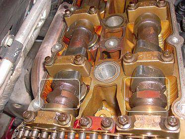

More then likely it's the exhaust cam that spun. you'll need to get the flats to sit even for both cams per side.
There should be some pics of the flats in this thread if I remember correctly.

It's best to have the tool that clamps the flats in line with the sealing surface of the head, as well as the key that locks the crank. The standard procedure requires loosening the exhaust sprocket, then tightening while applying tension. It's hard to get that set up correctly otherwise.

The flats have to be even parallel on top and from what I've read it's the exhaust cam that turns one or two teeth. If anything, even with the locking tool, you'd have to have the exhaust cam flat match the intake cam flat.
