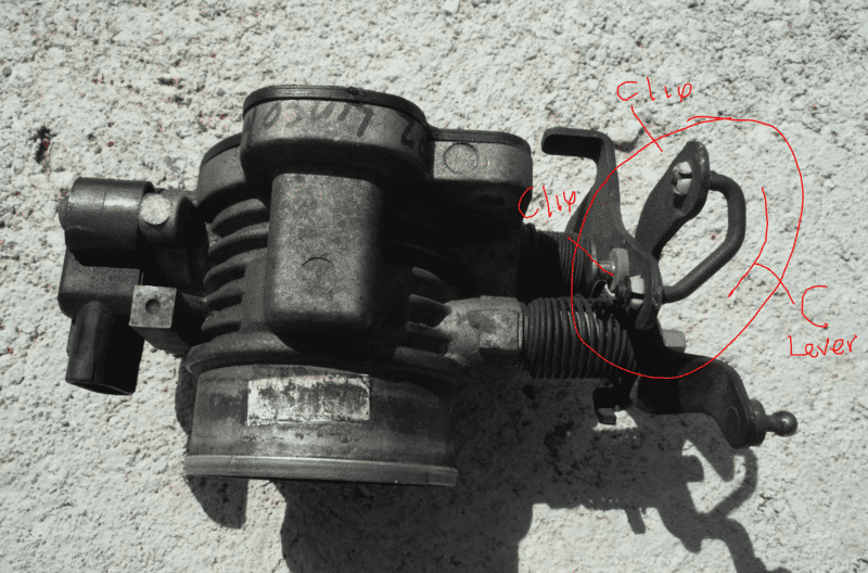

    My car can't accelerate cause it loose some retainers on the throttle body lever.
    pics uploaded(i took the pics for ebay good state throttle body)
    2001 LS V8
    • Do you know if i can get the plastic and retaner clips only? or
    • do i have to buy the entire throttle body? W_W
    • What's the right part name?
    • Any part number ?
    I search on ford part giant but not luck,also ebay,amazon,etc...:(
    I found a retainer clips, they are like D or C shape, but can't fine the plastic part.
    Aprecciate your help, thanks!

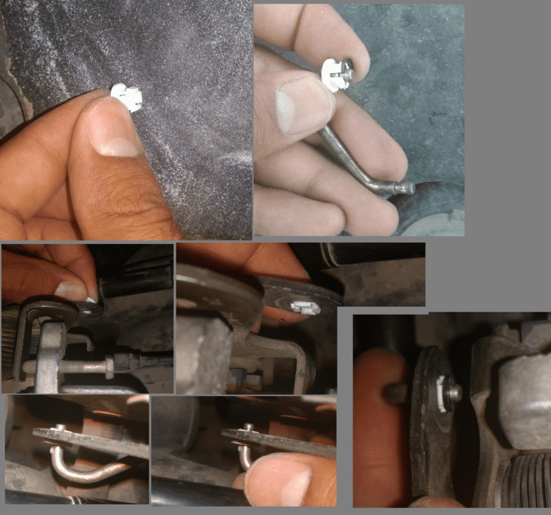

    I was driving so happy, full pressing and releasing the pedal accelerator until it stop responding, my first thought "The transmission" i pull over right away , the pedal feels different but not loose, i move the shift knob to D and the car started to move , then to R and move slow, i was trying to discover what happened, then i press again the accelerator pedal and the car did not anything.
    So i opened the hood, everything looks good to me, no smoke, no liquids, no codes( I carry on obd scanner always xD)
    I dont know why I pulled the accelerator cable and the car did not rev up, so i pull the other sided part , a closer one to the return spring and the car rev ups fine.

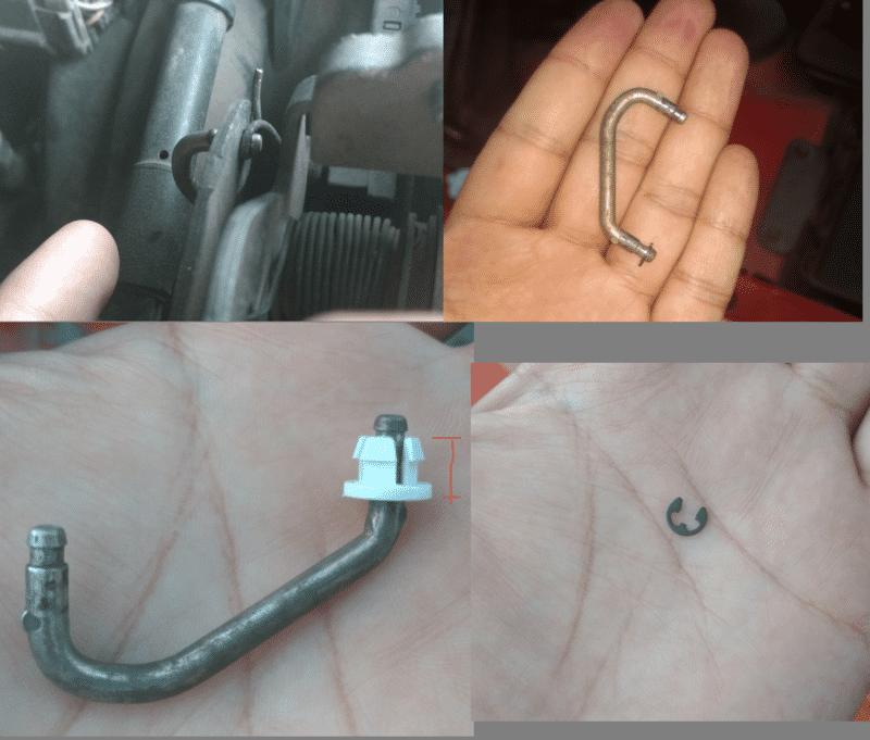

    I discovered a hanging " C lever" , that part connects the accelerator cable to the throttle body but on my car it was disconected.
    I took it apart and noted a brittle plastic which break apart instantly xD , it also has a " C or D retainer clips at the end, one of them went away, i was looky to not lose the C lever.

        Ford part number #F5RZ9F955AB , cost $9 dollar each
        doorman Help! #47099 , cost $3 dollar 5 pieces kit
        • The doorman's bushing clip have larger pin clips, you may sandpaper the pin to get the proper gap to insert the E-clip.
        • You can reuse the E-clips.
        • I did not unmount the throttle body, not much space to move but its ok,be carefull to not drop the e-clips&bushing.
        2 x bushings
        2 x E-clips
        Tools :
        • Needle nose pliers
        • Sandpaper
        Thanks for your help, I'm on the road again!
