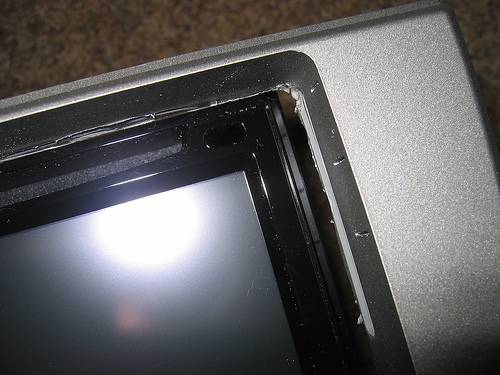

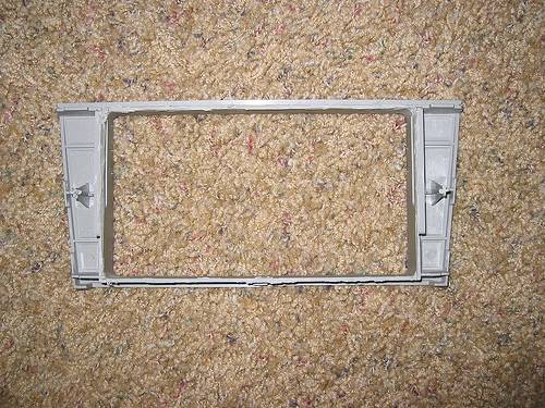

			had to slide onto the front, you wont be able to get the AVIC completely through the bezel.
clean up your cut edges a bit and squeeze her on through. YOu are almost there. THe D3 does need a bit of help going through the opening.
+1.
Your going to need to focus on the corners of the bezel. I think I switched from the cutoff wheel to one of those sanding wheels at this point to remove a bit of plastic, test fit, remove a bit more, test fit, etc.
Yes like LSEGUY said, make 2 relief cuts in the top corners where the avic is supposed to come through to slightly bend that top up to give it some more room. I cut mine in all 4 corners and then spray painted the inside lip black so the cuts could not be seen.

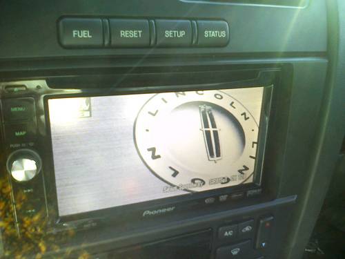

Hi, everyone:

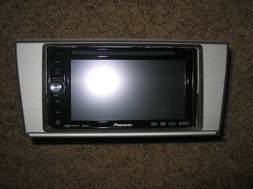

I've been following this thread with interest, as I'm in the process of installing a D3 in my 2002, but I seem to have hit a snag with fitting the D3 through the dremel'd faceplate. I've removed everything from the back of the faceplate, but the D3 still won't fit. It looks like the curved edge on the corners takes up too space for the squared-off edges of the D3 to fit through.
Everything that I've read says that you only need to dremel stuff off the back to fit, but it looks like I've taken everything I can from there, and it still doesn't fit.
Any ideas?
(here's some pictures - hopefully they show clearer what my problem is ...)

Thanks for advice, guys - I'll give that a shot and report back![]()

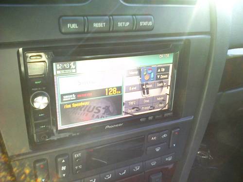

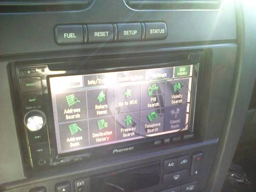

Well, your advice worked. I made relief cuts at the top and bottom at the back of the faceplate, and with a bit of patience and force, I got it to fit! After all of the hacking I did to the back of the plate, I'm surprised it looks so well on completion
Now, I have a new problem. After testing everything and making sure all of the connections are secure, I can't fit the unit into the radio "hole." It seems that, with the aftermarket harness, etc., there's not enough room behind the unit to make it fit. At best, I can only get it within about a half inch of where the frame bolts in. Any advice before I start tearing the dash apart again? How did all of you get the wiring to fit?
Deja vu. Bad memories.
Remember the patience you utilized to get the unit to fit into the faceplate? You'll need a bit of that again.
Its a snug fit, but it WILL work/fit. Before you plug the headunit into the harness, reach in there and tuck away...to the sides, buttom..as much of those wires as you can. Be careful not to pull apart any of your soldered connections, but you want to make sure wires arent excessively crossed or binding, and tuck as much away into the nooks/corners as you can. If I recall, I think there is some space over to the drivers side rear of the hole, and maybe some more space over on the other side. Once you are SURE you have all wires tucked as neatly as possible, go ahead and plug in the Avic. As you push the avic into the opening, use a flashlight to shine above, bottom, and sides of the avic to ensure no wires are getting pinched between the avic and the opening. As lone as no wires are getting pinched, keep on pushing. When you get it in far enough, hand screw the bolts that secure the headunit into the dash. Then going in a rotating fashion, tighten each one with the socket. A little at a time with each one. The avic will slowly go into the dash into the proper position.
