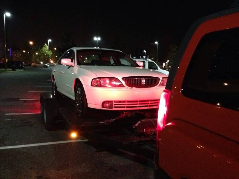

3.) Frustrated and drunk LS owners whos car left him stranded in the middle of a place you'd rather not be at 11:30 at night in Philadelphia!
Being as I was over an hour away from my home, the more reasonable solution was to call for a tow. ...and since that was and hour + I limped it a mile up the road to the casino parking lot and went in for a few beers, might as well I'm not driving anymore. Regardless I had a few beers which led to this post, so sorry to get a few of you guys panties in a bunch. I've owned this car for over 5 years now and it's just getting old to be driving and suddenly the car goes into limp mode because of a coil, countless times.

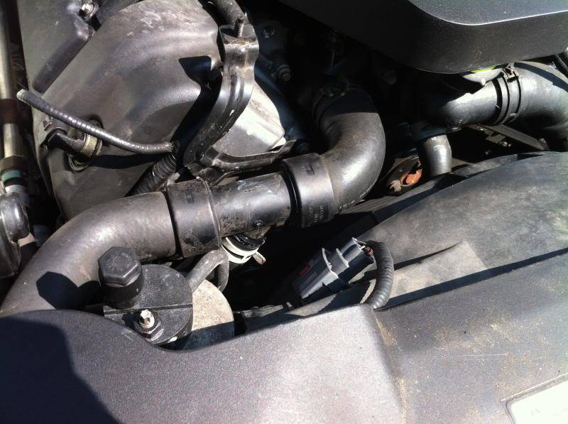

I digress... Here's what happened in a nut shell: Driving down the road, sudden plume of white smoke, pull off the road, jet of hot steam, phone call.
[video=youtube;xKBwmFzpWWw]http://www.youtube.com/watch?v=xKBwmFzpWWw[/video]

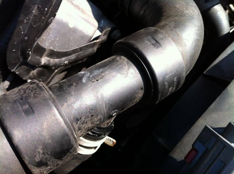

The plastic coupler for the "upper radiator hose" decided to crack and jettison all the coolant from the system.
If you look closely you can see the crack.

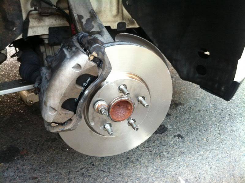

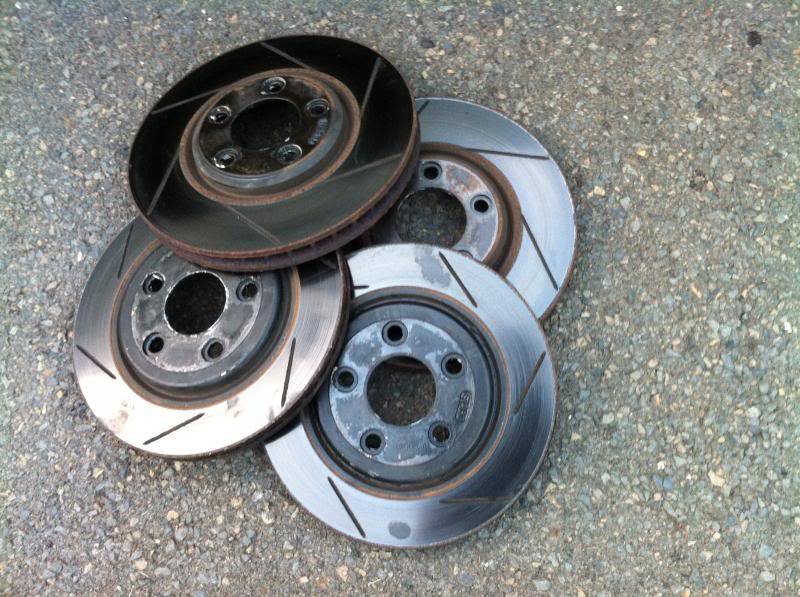

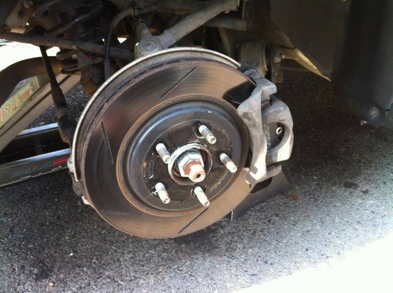

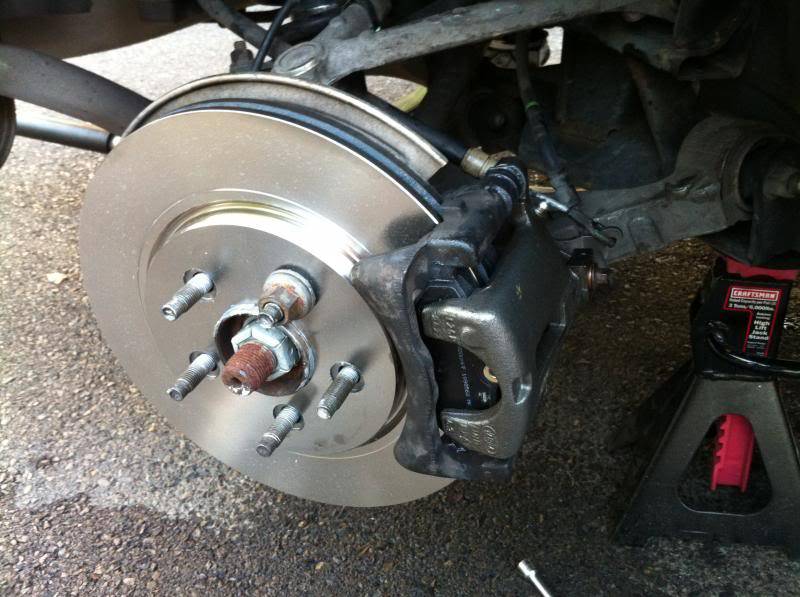

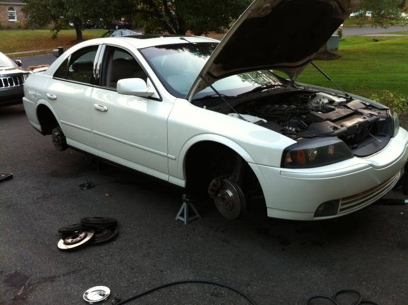

Also about two weeks ago the one rear caliper guide pin seized causing premature wear on the one inner pad. This wore down the pad to nothing and destroyed my one rotor. Since I didn't have all the parts I needed two weeks ago I just bought crappy rear pads and sacrificed them for the time being. In the meantime I bought all new rotors, pads, guide pins/boots and new rear calipers. Thought that since I was already working on the car I should fix my brake problem as well, seems smart.
Buh bye
Garbage
New stuff
Heh heh, that is true. However, we have seen trolls from the other make/models here before, and I'm not too good at remembering who owns what. No matter... my own car sprang a leak from that stupid plastic fitting which caused me to redo my entire cooling system. Time bomb there, found that several other plastic parts were crapping out at the same time. The thermostat housing was broken inside and the degas bottle had several cracks in it. Good luck with it all.
