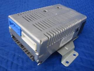

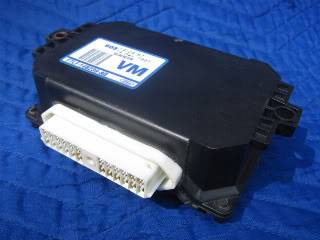

A VCLM - Variable Control Load Module (F7LF-14B239-AB)
SCIL module - Steering Column ILumination module (F8LB-13C788-AA)
These will be installed soon. The VCLM is located inside the passenger side forward fenderwell.
The SCIL module is located on the passenger side behind the glove compartment. These parts are fairly easy to install.

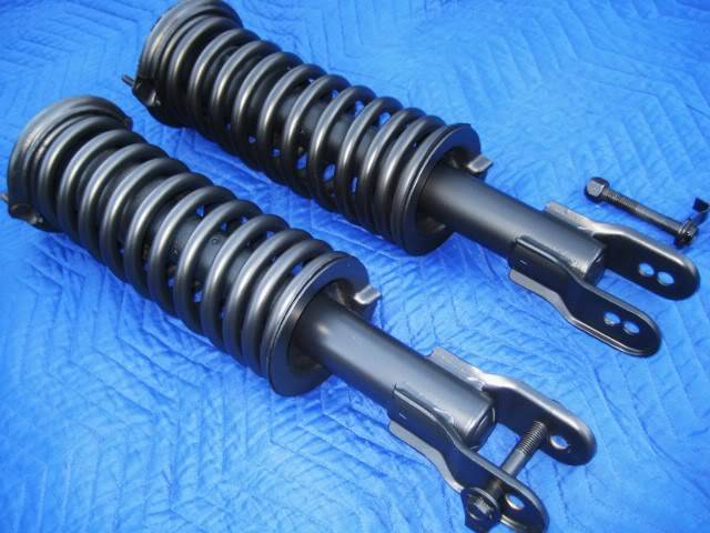

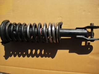

Took out the original air springs front and back because of their bad condition. The air compressor is bad too . I will have to get my neighbor from up the road, Eddie from Del Rio, TN to recondition them for me later.
I bought a used set of Monroe Sensatrac coil springs for the front. These are going to be modified to sit lower than the factory ride height. I also bought 2pairs of used oem air springs that will be trimmed and modified to sit lower than the factory setting.
In this segment, you will see some of the steps I have taken to do the modification.

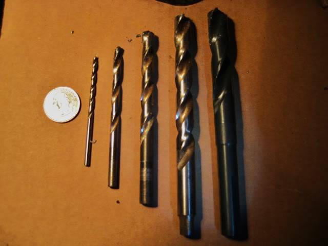

Several Drill Bits - largest bit = 9/16th inch
A Drill Press
Pilot Bit all the way up to the 9/16" Drill Bit

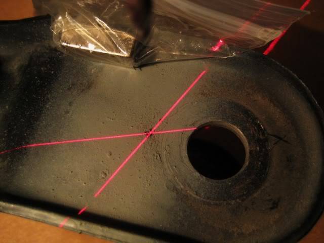

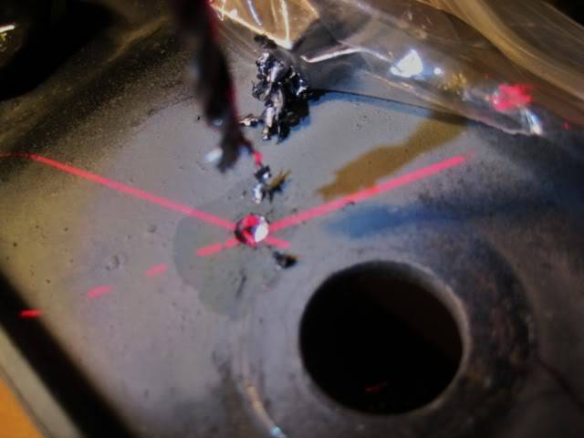

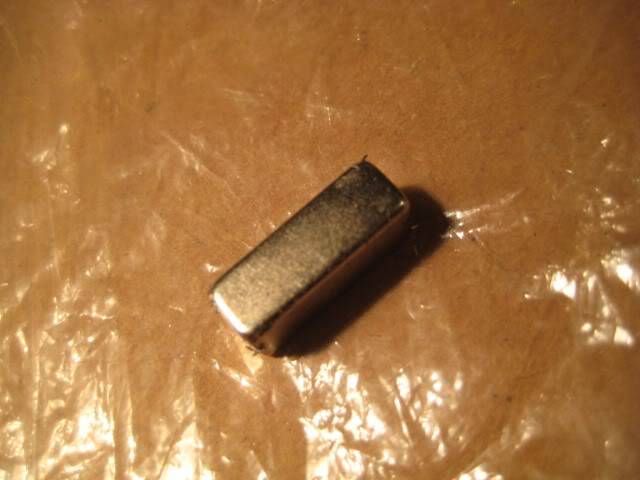

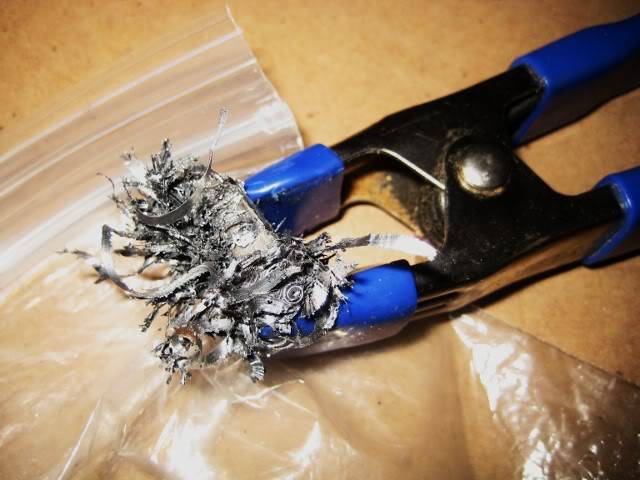

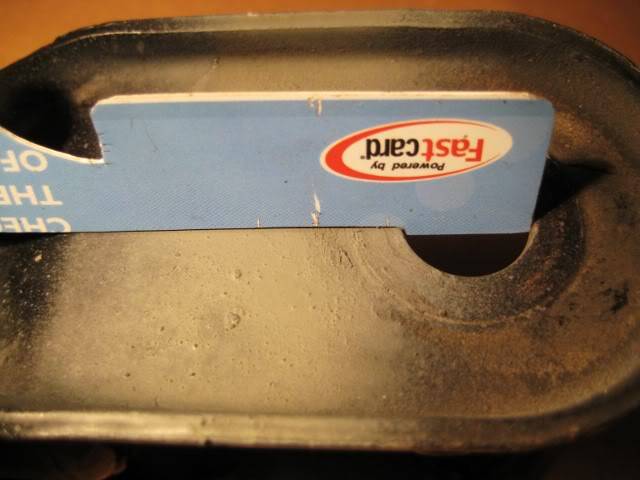

Magnet and Plastic Sheath. This is a neat time-saver idea to keep metal shavings under control. Using the clip, Place magnet near the drill bit to collect the metal shavings. Just peel the plastic off the magnet to dispose of shavings.

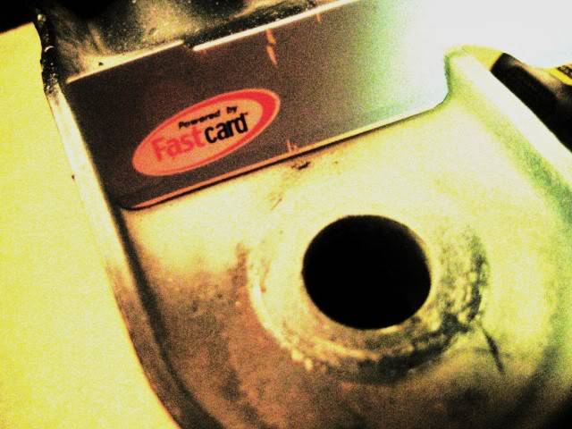

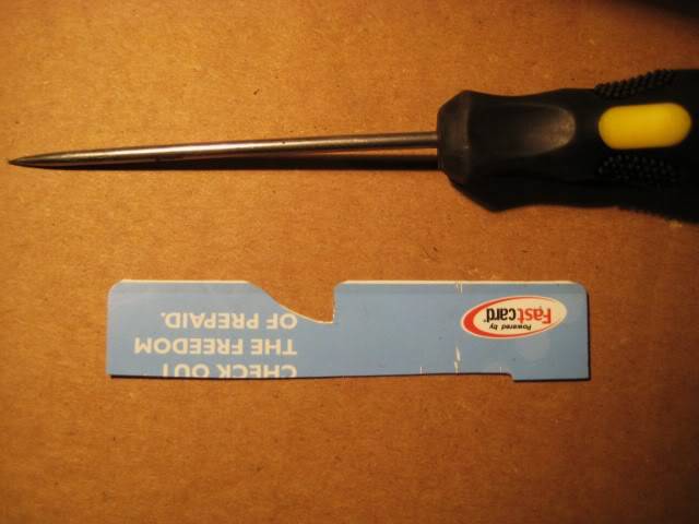

Old Gift Card and a Scratch Awl used as the Hole Centering Template. Cut the template to fit snuggly within the hole and the lower strut mount cavity.
Paint surface with primer to easily see the new hole marks you will make. Create a notch on the gift card to partially go in the hole used as the guide. Using the scratch awl, Mark the card at 15mm from the center of the hole to the center of the new hole to be drilled.
Notch the opposite side of the card to fit within the strut mount U-shaped cavity. Mark the center location for the new hole using the original hole as your guide.

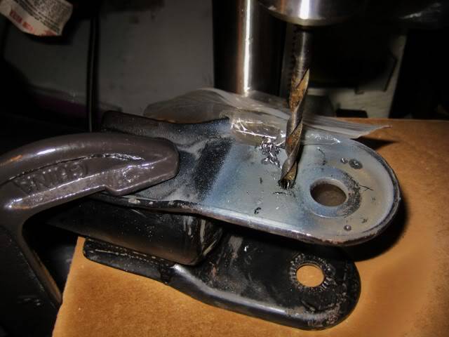

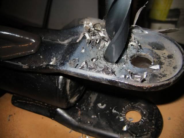

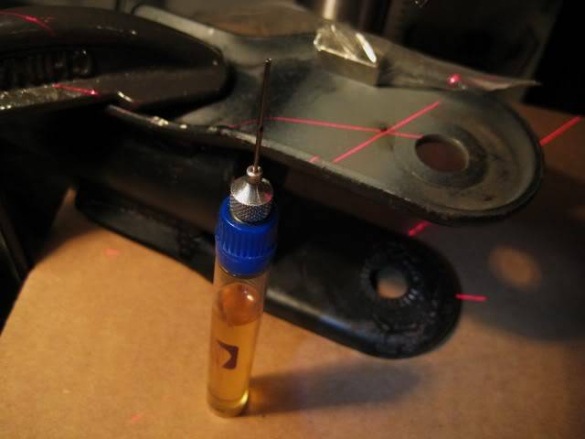

One of the more crucial steps to be done. Clamp the Coil Spring (or Air Spring) assembly to the drill press surface making sure the drill bit is perpendicluar to the work. Prepare to center the drill bit over your center mark.
Oil the drill bit and the metal surface.
Stop often during your initial drilling making sure the pilot hole remains centered. Magnet keeping work surface free of debris. Allows full view of your center mark.
Drilling progressively to a larger hole.
Metal shavings ready to be discarded. Be cautious when handling the sharp metal shavings.
9/16" hole being drilled.
Test fitting the hole with the bolt.
Test fitting verified.

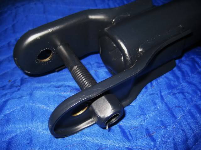

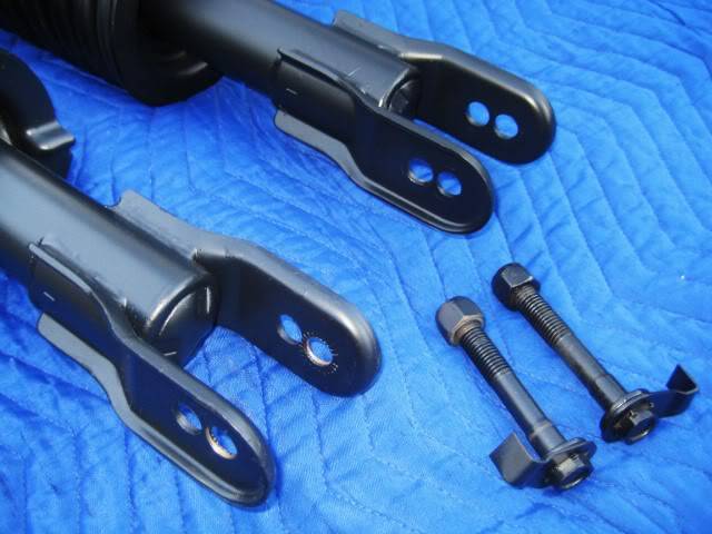

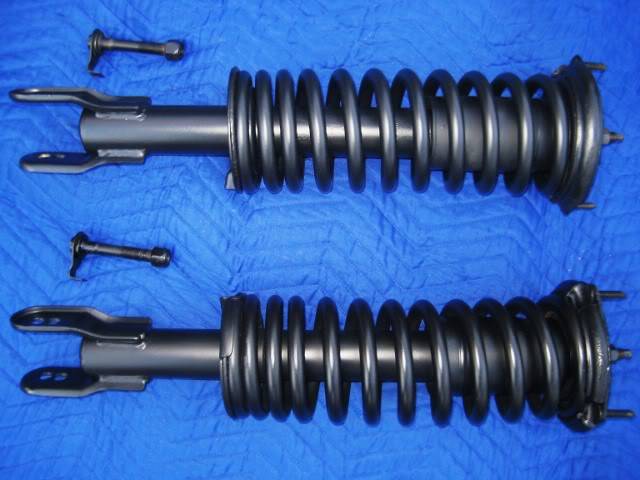

Final product after being sprayed with Satin Black.
Looks Like-New.
Ready for installation.

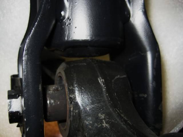

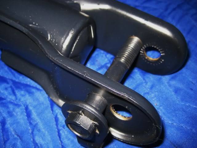

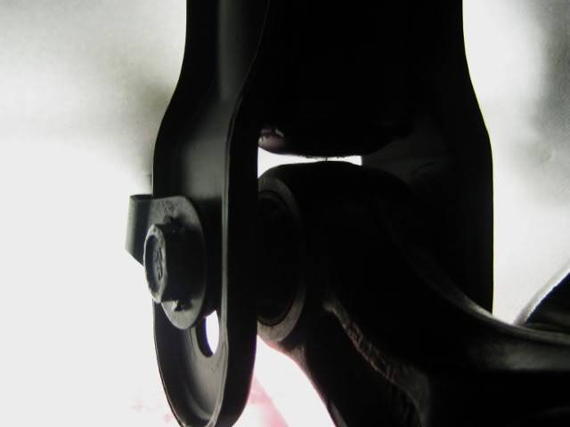

Installed view. Here is what the 2.0mm clearance with the Lower Control Arm looks like. Double check your measurements and calculations before drilling the hole because different strut manufacturers may have slightly different specifications regarding the bolt hole center distance in reference to the bottom strut cup.
Back lit view of the 2.0mm clearance.
This modification can be performed on an Air Spring as well as a Coil Spring. This modification took approximately 4 leisurely hours to complete and that's including paint drying time. This is a great way to modify your Air Spring if you are looking to keep and maintain the factory ride quality as you lower the front of your vehicle.
On an Air Spring, additional lowered height can now be achieved along with using the sensor adjustment method. This combination provides minimized rolling oscillation while it maintains near factory ride quality or in other words, without that bouncy ride quality with just sensor lowering alone. Keep in mind that as the system lets more air out of the air bag, the less control it has over oscillation.

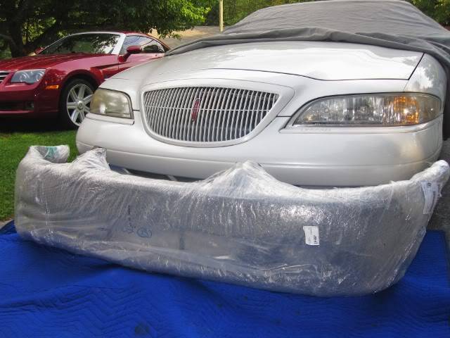

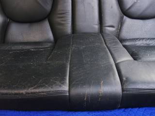

Came in yesterday from FedEx. Ordered replacement rear leather seat and backrest. This one came from a '97 Mark VIII with Ebony interior. Same model year and interior color code - (DJ). It should be a direct color match with the rest of my interior.
It will be replacing my old, ripped, worn out, "sharp claw" K-9 damaged rear leather seats.
No, I think it's a cobra bumper. The center opening doesn't look like it goes down far enough compared to the headlight openings
I'm lovin this thread. It's like daily, something is coming in for this car and things are happening. I know it was looked at in the beginning as just another white Gen 2 with Octi's and dents and dings but I believe a lot of things are about to change on this car and fast.
I can't tell what that front bumper is from. Might be a Temple or a Cobra or something he had made himself with his own design?? I guess we'll see soon.
looks like it goes to a mustang.
i demand photos!!! LOL this is like months of work, crammed into a couple days!

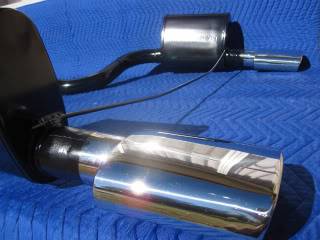

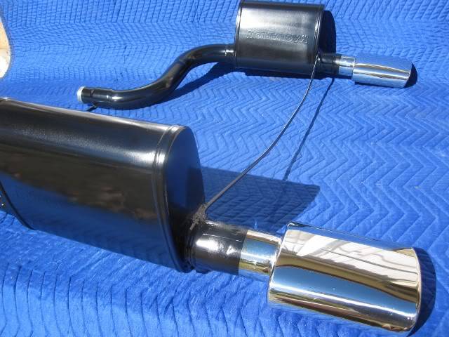

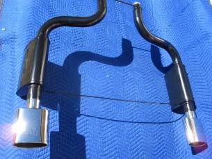

In this segment, I will show you what is being done for the exhaust. I decided to upgrade the exhaust system one section at a time in a modular fashion beginning with the mufflers and tips. The rest of the system will be ugraded later and ultimately ending up with a full 2 1/2" diameter pipe setup from the exhaust manifold.
The look of the exhaust tips from the back of the car, to me, looks anemic (pic 1 & 2). Probably because the tips have been dragged and crushed against the ground by whomever towed it when it originally brokedown. Note the tips drooping and off center. I tried my best to remove the pancaked look and tried to open it up a bit making it look rounder (pic 3) but it just wasn't working for me. I guess it's the rim of the tip just looks too thin and narrow.
I ordered a pair of Magnaflow 11376 straight thru, 2-1/2" inlet and outlet pipe diameter, mufflers and a (larger than factory) pair of angled 7" x 3" oval chrome tips with thicker rims. I also ordered two U-shaped 2-1/2" aluminized mandrel bent exhaust pipes from Summit Racing. I am partial the single tips because double tips look too El Dorado-ish to me.
Other accessories I needed were pair of exhaust hangers, 48" x 1/4" metal rod and two 2-1/2" to 2" exhaust pipe reducers.
Had everything mocked-up, cut and welded together. Prepped and cleaned, I painted the whole thing with VHT gloss black engine spray paint except for the chrome tips and at the end of the pipe.
The metal rod acts as a center alignment bridge between both sides of the mufflers. This helps maintain pipe alignment during installation and that both tips are centered in its proper location once viewed from the back of the car.
The majority of the Magnaflow muffler body will be tucked inside the muffler well to minimize the bulk appearance as its viewed from the side. The black paint helps camoflage it so attention is drawn to the chrome tips.
The tips are angled slightly upwards on its side so it follows the lower body contour of the rear bumper. This is a great way to remove some weight off the car. The whole setup weighs in at just 21 lbs.
