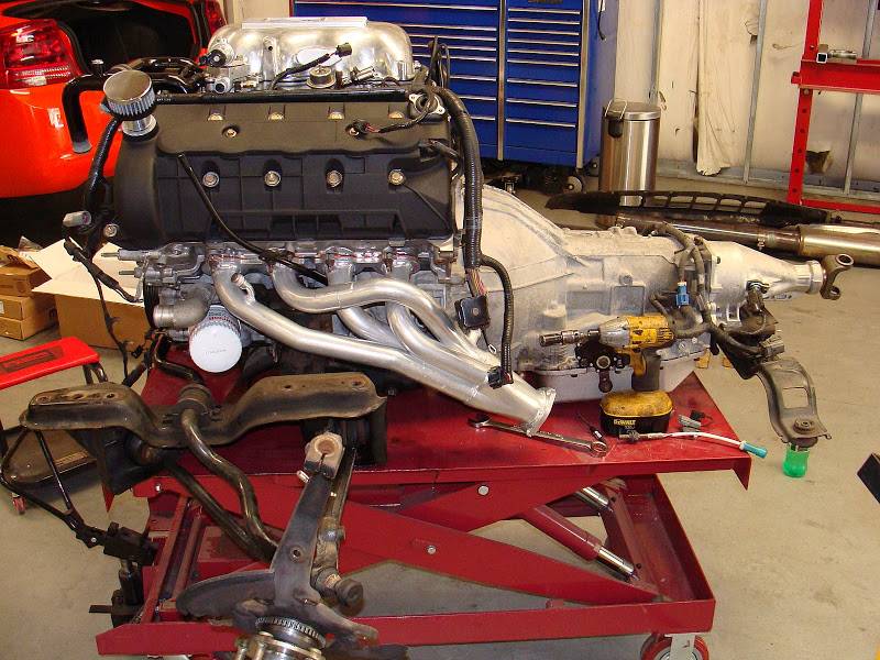

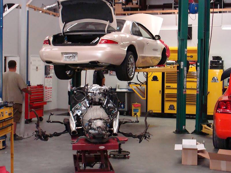

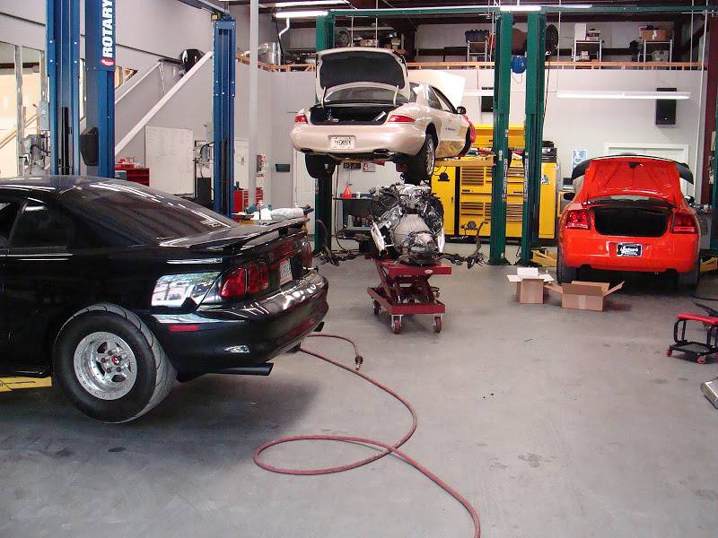

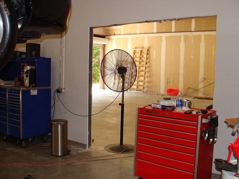

Aric had to make a executive decision today. His business enterprise is expanding, and he is doubling the size of his shop this weekend. So, that means the Mark has to come down from it's perch on the lift, and become a "roller" being towed by his golf cart so he can knock down a wall tomorrow.

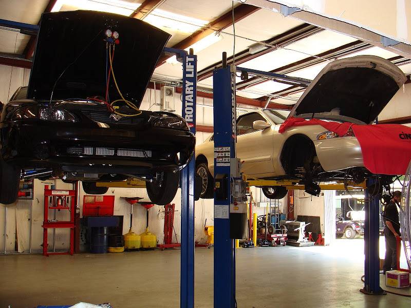

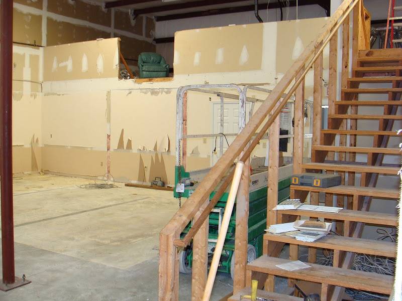

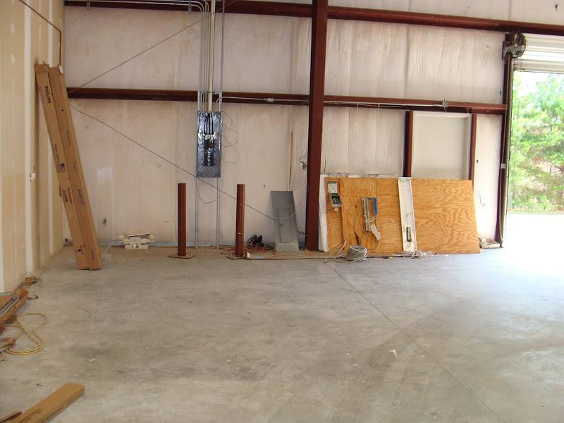

He is going to come in on Monday - his day off (they are actually open Tue - Sat) to install the motor. Here are some pictures of his new space, where he is going to have more lifts, and his dyno from his other shop put in. He will finally be under one roof Here are some pictures. Congratulations, Aric, on the new space!

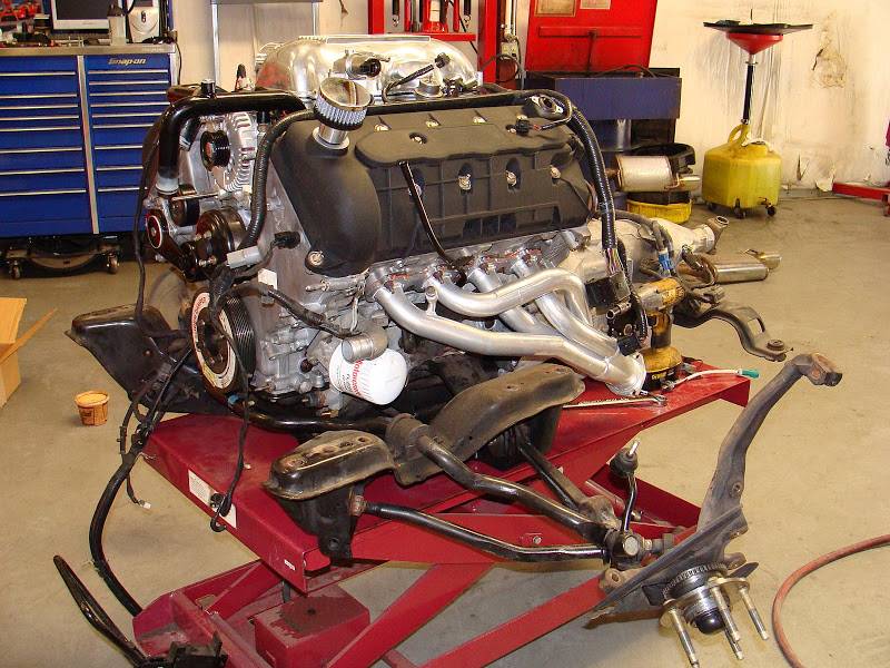

those studs on the hubs look odd are the from a cobra? or is the picture just messing with me?
other wise looks awesome! cant wait to hear it!
Thanks, Guys :) Good eye on the wheel studs. Not the stock studs. They are hardened ARP racing wheel studs. Aric had to machine the new Cobra front hubs to make the ARP wheel studs fit.

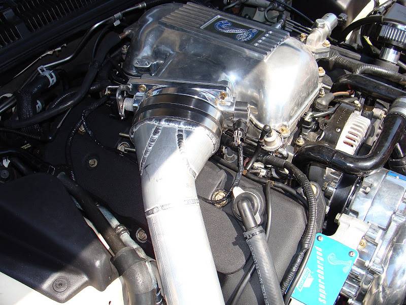

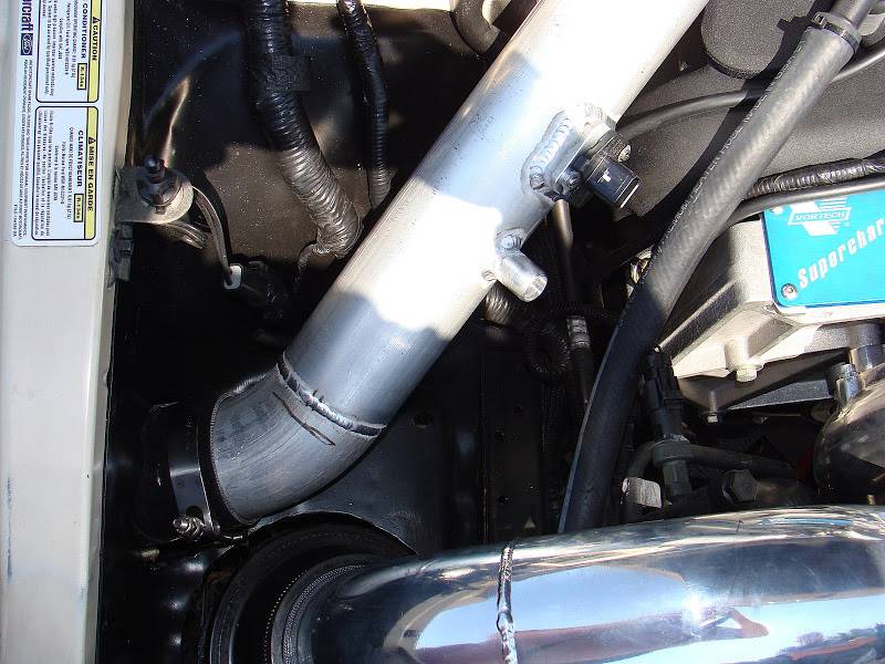

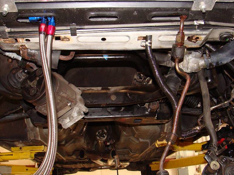

Here is a picture of the braided SS trans cooler lines. The cooler is a OEM Ford truck plate type. All custom work - done by Injected Engineering, and Bradshaw Bros. - (transmission builders)
