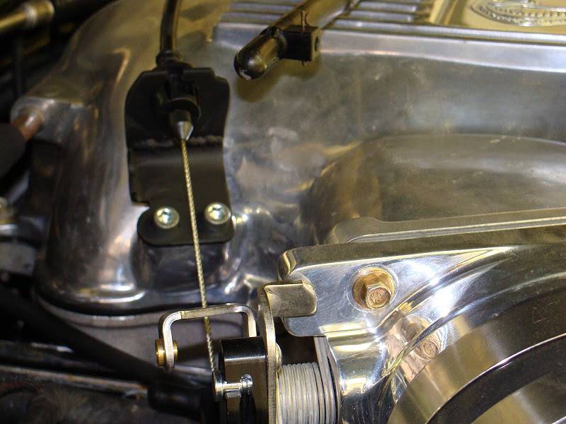

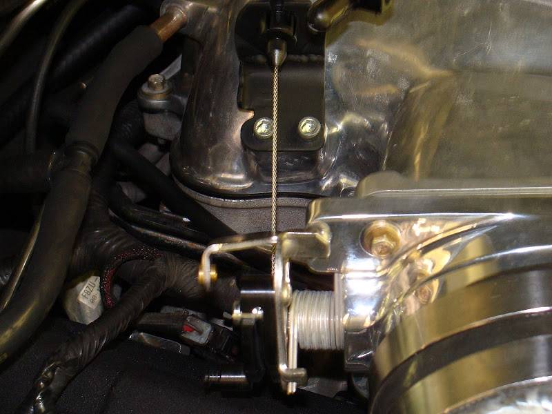

The throttle cable and bracket have both been replaced. Here is a picture of it below. Aric has to put a return spring on it yet. Don't quote me, because I am not sure, but I think he said they are both from a Ranger pickup?

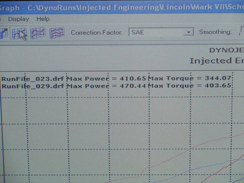

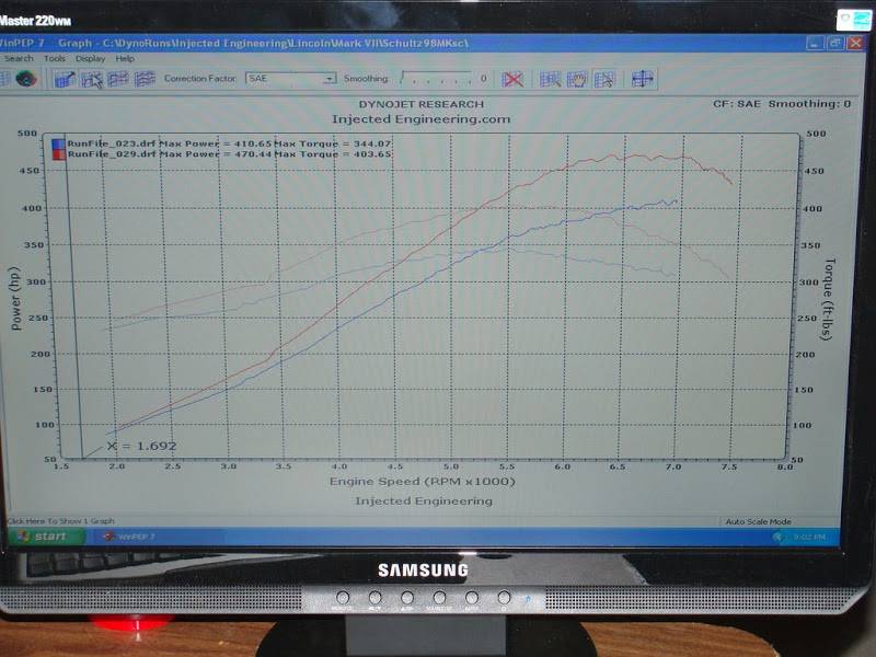

That stroker motor really helped out in the torque department. The old motor and 3.1 pulley on the dyno produced 402/318. The new motor with the 3.1 pulley produced 410/344. The new motor with the 2.7 pulley produced 470/403. :)

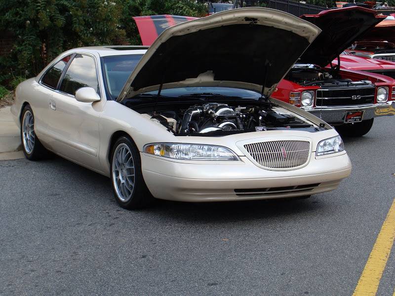

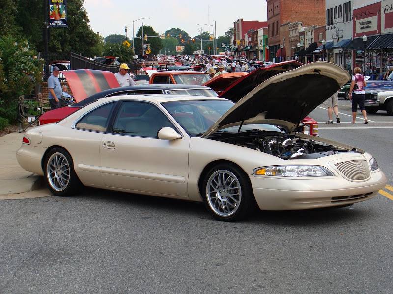

Here are a couple pictures of the Acworth cruise in this past weekend. Nice turnout as always :)

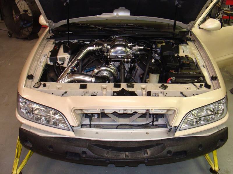

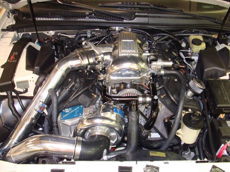

The Mark has been back with Aric since last Tuesday. He is going through the punch list now to get it ready for SSHS8. The first thing on the list, is to address the MAF tube.

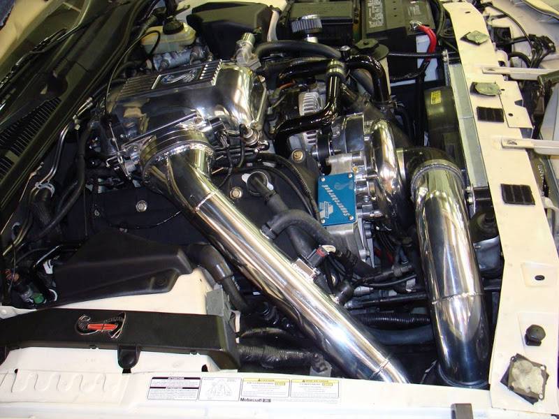

He is going to put a second Vortech mini-race blow-off valve on the passenger side tube just beyond the aftercooler exit that leads to the throttle body.
The one already on the car is located in the drivers side tube just before the aftercooler entrance. The two blow-off valves, and the cam cover oil recovery tank are all hidden from view from the engine compartment.

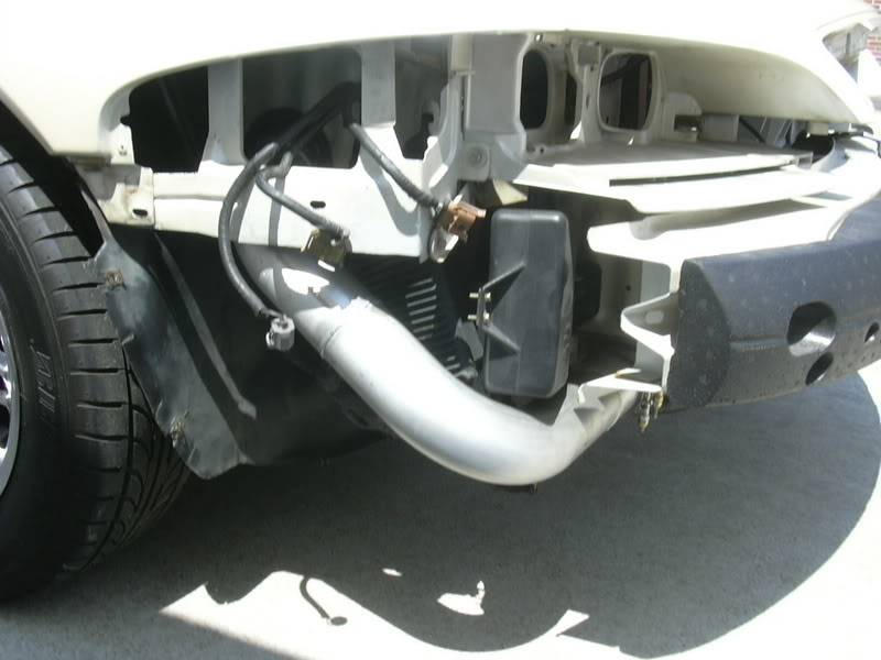

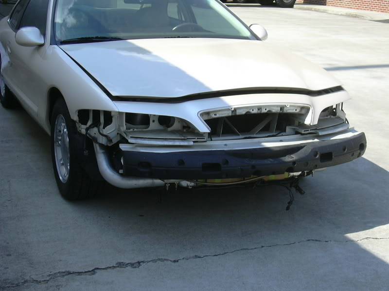

Here is a picture of the general area for the new blow-off valve
If the second blow-off valve does not solve the tube problem, he is going to weld on a boost bracket to the tube, and the intake to fasten it down.
