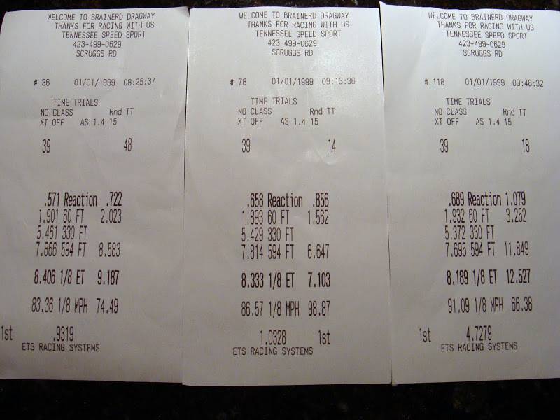

Here are the time slips from last night
ok i am not track fluent so in the 1/8th mile, one of your times was an 8.1, my buddy told me, i think this is what he told me, to take your 1/8th mile time of 8.1, divide it by 2 which is 4.05 and add that to the 8.1 to get a rough idea of your 1/4 mile time which in your case would be a 12.15 e.t roughly is this correct or close enough?
Times by 1.54 (most cars are very close) for the time and add 21 to the MPH.
Thanks All! :) There are some calculators out on the web that can translate a 1/8 mile into a 1/4 mile time to get an idea. My car does best on the big end of the track when the rpms are 5500 and up. lol It is pulling like a freight train up there. :)

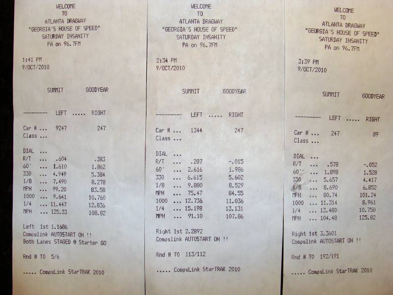

Well, Here it is lol :) The good, the bad, and the ugly. Just too daggum hot out today for The Mark. Each pass went the wrong way by around three 10ths. I tried to go around an hour between runs, but it showed a outside temp of 90* in the car for the third run, and I am sure tons of timing was being pulled. So, not much learned other than the car does not like it in the heat.
First run was with the manual shift lock tc in 3rd tune, second run was with the manual shift tune unlocked tc, and the third run was with the manual shift lock tc in 3rd tune again.
I stalled the torque converter all three runs around 2000rpm - pushed the car into the second beam as hard on the brakes as I could. The red light on the second pass, I had push the car so hard I deep staged and turned off the first light.
