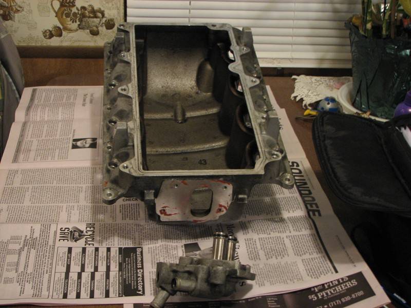

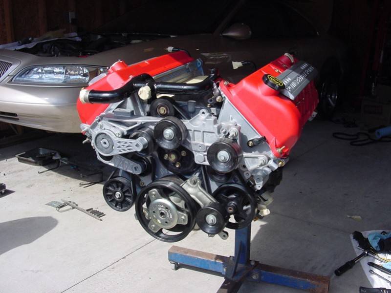

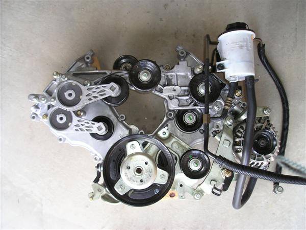

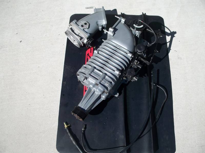

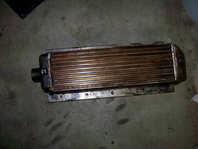

You can buy a stock eaton for 200 bucks. But your looking at another buttload of cash for the supporting hardware to make it work. This is just a sample if what is needed. In addition ot this, you are STILL gonna need the C-heads, and engine built to handle it.
IF I were you, I would get the C-headed long block built, and call up Kenne-bell and order thier intercooled 99-01 cobra kit. You will be MUCH happier with the result.
