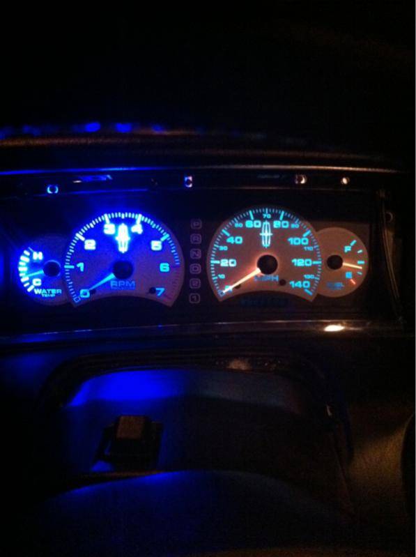

Here's a pic to compare LEDs and regular bulbs in the gauges
I think it looks pretty good but u cant really see the red with the blue bulbs
