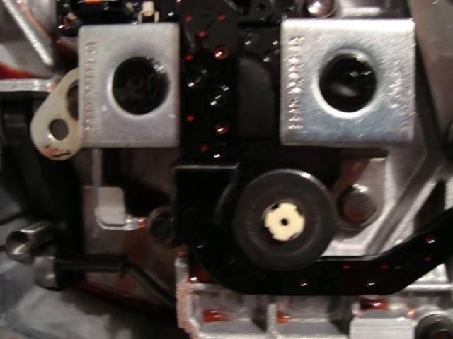

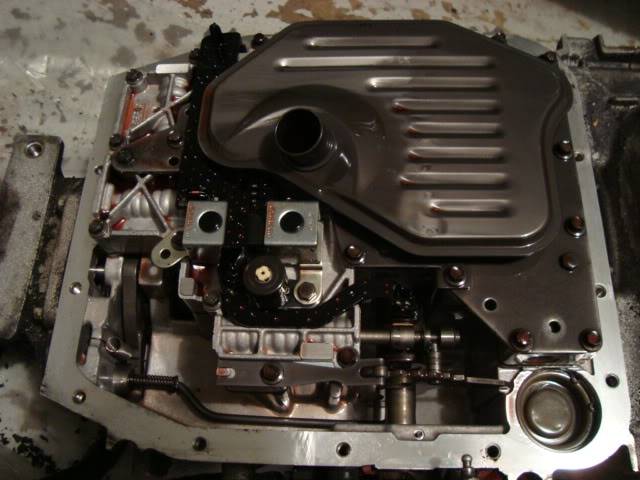

This is the 98 trans when I had it apart.
Easiest thing I ever swapped in my life.

When you drop the pan and take the filter off you will be staring at the solenoid. It has 1 bolt holds it in place, you pop the old one out, pop in a new one, bolt it in, put the filter and pan on, and fill'er up.

Only have to drop the VB if Im replacing the 1-2 accumulator? Selenoid is easily accessible from on the ground? (Driveway Mechanic) Lol
No, the valve body does not have to be removed for the 1-2 accumulator replacement. See pic above. See the round thing in the bottom right hand corner? It is held in with a round clip that will require clip ring pliers to remove. Use a C-clamp to put just enough pressure to push the piston in and the clip can then be removed much easier and it won't jump out at you. It is spring loaded with 2 springs. One blue and one purple. If you were doing the 2-3 accumulator, then yes, you would be removing the valve body.
