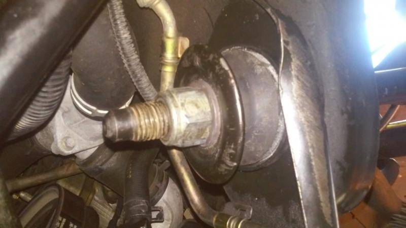

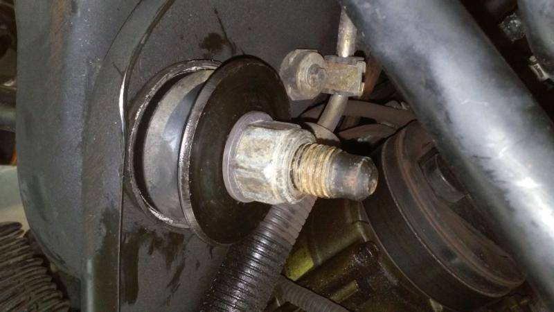

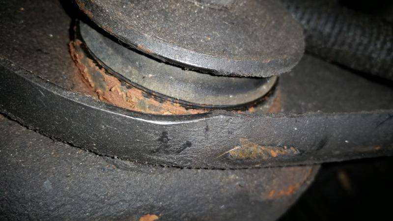

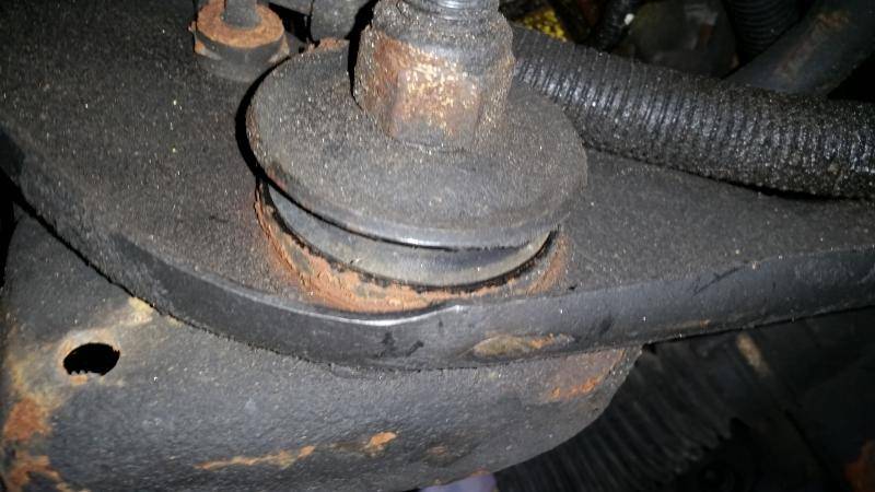

Hi Guys,

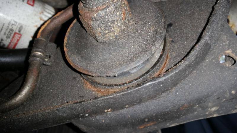

When I first looked I thought these were fine. What do you guys think?
With everything apart (have removed the LCA) and it would just be the outer bolt (by frame) on the Strut Rod to change the frame bushings.

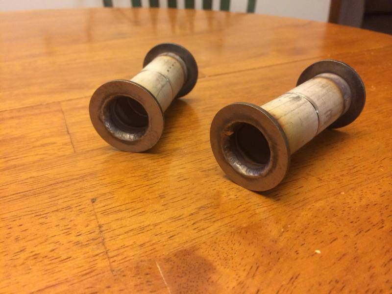

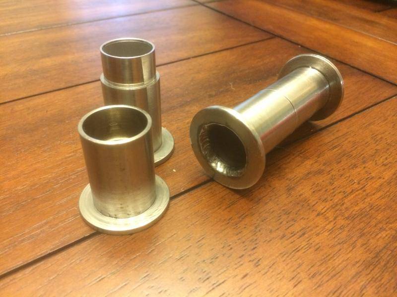

Two questions:
- I take it that you all think mine (pics above) should be replaced?
- You need the sleeves (discontinued, think Jay or 98lincmk7lsc was making some?) for Ford K member bushings, yes?
(pic in this thread near the bottom)
you might as well while your there right?
http://www.lincolnvscadillac.com/fo...ension-Work-Issue&highlight=upper+control+arm
my sleeves were in good enough shape to reuse.
if your's are not, talk to Jay.
Well I hear you Chris. I'm thinking of the time that's all. By the time I get sleeves from Jay into Canada as well as the bushings, it would mostly likely be another week.
If mine would last to next summer I wouldn't mind replacing them them. With only 5 to 10K miles a year, I would think by looking at them that they would last two more years?
yeah they haven't seem to have collapsed yet.
they'll probably be alright for now.
Mine are both starting to crack/split. I really need to get in there and change them already :/

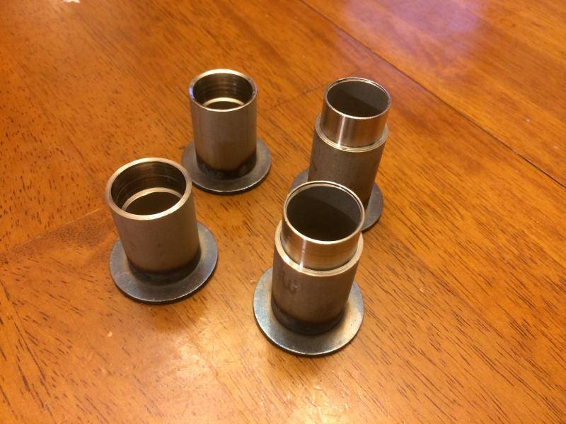

I've always got the parts in stock to make these. Unfortunately, don't always have the time to make them quickly.
When/if you're ready for them, they're $135 shipped, and I now stock the OEM bushings to go with them at an additional $45 a set.

I decided to wait with it now November and the Frame bushings looking okay. I took a closer look and I can see the edge of the sleeve, so I would think they would be fine to reuse when I need to change. I will check this next spring and if I do need a set will let you know.
I just did this job on my 97 Mark this past weekend, and it was a PAIN. To replace the front strut rod bushings I had to cut out the original sleeve with an angle grinder because it's 1 piece (seemed like the sleeve was rivited on the front side). I don't know if all the Marks came that way from the factory, or if some came with sleeves that could be separated and re-used. (I got my replacement sleeves from SPREE, though I know Jay's are really nice too).

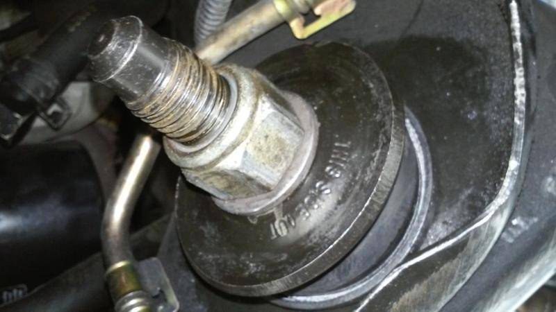

So I just replaced my SRBs and figured I'd post a pic. Does this look weird to anyone? It seems like it's taller than most of the ones I've seen. I torqued everything to spec though.
will you die immediately? probably not.
should you change it asap? yes you should.
With the washer not supporting the bushing, I would think you run the chance of damaging the new bushing. These are pretty hard to find, if you can at all, I searched for days with the help of others here and couldn't find all 4 of them.
So I would change it ASAP.
Ok I got it turned over. It's funny that on the washer it says, "THIS SIDE OUT". Of course I ignored that the first time.
I did put the other side on correctly though. :) How does this look?
