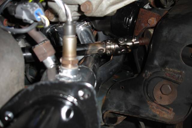

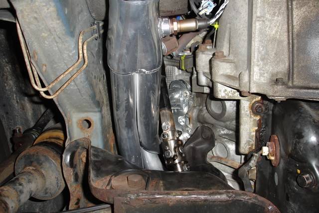

still looking for a pic with the cobra manny's installed if anyone has one..
think i found it -
What thread is that picture from? If any.
Not sure, found it last night hiding deep in my files. Should of looked there first but I knew i've seen it before, I found it in my folder of over 4,330+ pictures that are 95% Lincoln Photos.
So now looking at that pic, anyone think Kooks will fit with this steering mod?
No. They wont.
Good to know, thanks. :)

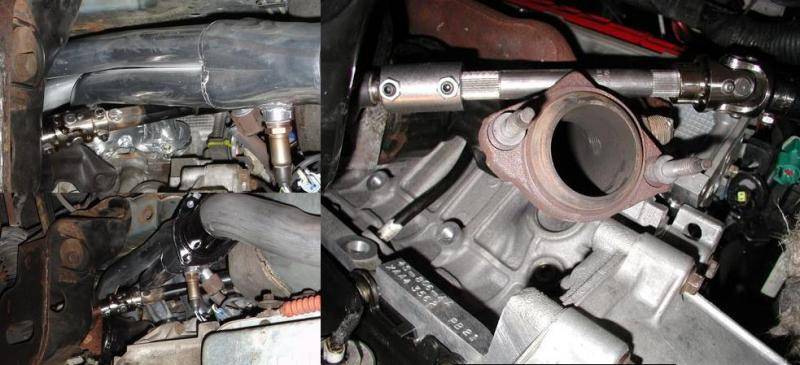

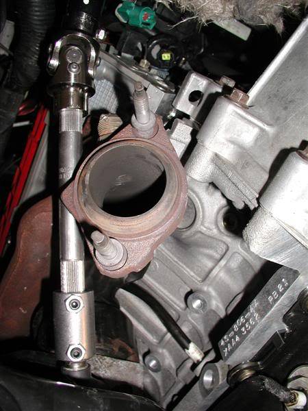

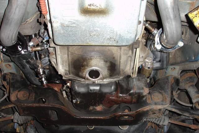

If someone has a picture of the kooks installed with the steering shaft modified from this angle that would be great to add to the write up Header/Manifold options Install for Mark VIII
+1 For folders dedicated to Lincolns, and the mod motors! :D Care to share some?
Thanks driller.
Warrior - just moved and still settling in, have to organize those pictures, what are you looking for? I started a thread awhile back of abunch of crazy stuff, most of the stuff i have is of my own car/tech related pics I saved, like the ones posted in this thread.
after looking at the pics seems as the mod for the cobra manifold would hit the kooks, thanks for the pics! ;)
