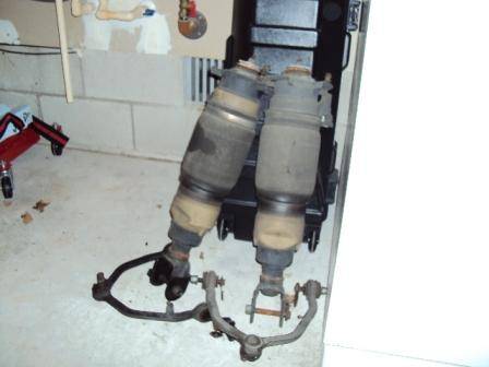

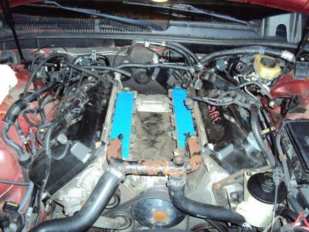

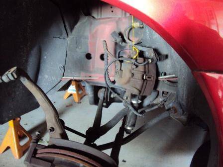

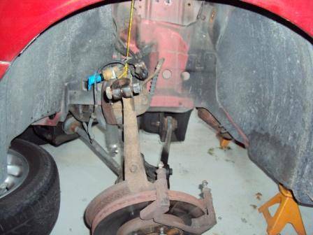

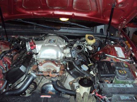

Made good progress today. Tomorrow I'll drop the cradle and start installing the headers and new motor mounts. Looks like I need new UCA I couldn't leave them on the car as it was only a little extra work to remove them.
Well I used the welder for the first time and it looks fine with the flux core wire. Not sure why some are making it a big deal. By no means are the weld perfect but thats not the equipments fault. If some of you have had issues with the gas vs flux make sure the polarity is set right. I had that issue before when using gas but the machine was set for flux. Alot of spatter and holes looked like the metal was really dirty.
Any one know what size the cradle bolts are. E what 18?????? I thought I had the right socket cause it was the only external torx one I had. Of course its the wrong one and no one stocks them locally.
Use a 6 point 9/16" socket... fits perfect.

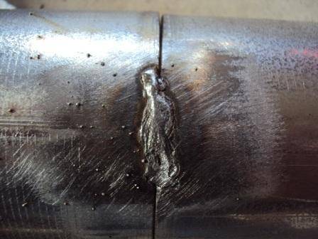

I know I shouldn't post a pic of this weld but I will. Keep in mind I'm not a welder but have melted some metal before. This is the very first and only weld with this machine as of yet. I had to see how bad it was going to be. I did clean the haze off with a striper wheel.
Looks good!!
I just can't stand the little splatter blobs everywhere... Looks like you might be a little low on heat...
Yeah not as bad as I was thinkin. I'll hit that with a flapper wheel. That was the first shot I went with 2 power and 35 speed and thats what I got.
Try clicking the heat up one level and see what happens if you have some extra material to work on.
