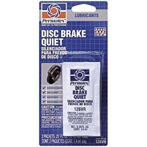

Did you use a little bit of that anti-squeek stuff on the BACK of the pads? That's what it's for & it looks like this:

I used the disc brake quiet on the back of the pads and slide guide on the pad guides and caliper pins/bolts. There is no play from side to side or up and down with the wheel when jacked up. Also I do not get any road noise. Just a squeaking sound until I hit the brakes.
