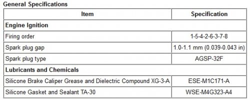

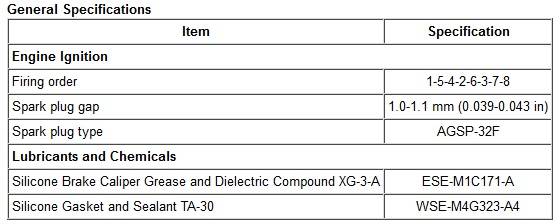

OEM is NGK.
It's important to verify that the gap on each one is truly 1.0mm.
OEM is NGK.
That's about .039". I believe my '03 sticker says 1.1mm(.0433") It couldn't hurt to close them up just a little more. My car currently has Denso's in it, and they were gapped about .054" out of the box. That's way to big for the weak insulation that the boots provide. I gapped them at about .034" hoping that the lower firing voltages will preserve the coils/boots a little longer.

My experience is that the gap gets larger as the plug ages (electrode erodes), so I set them to the minimum specified so that they aren't past the maximum before it it time to replace them.
Smaller gap = lower voltage, but higher current. Correct gap (in spec range) = best transfer of power to the ignition.
You are correct. I also set the gaps at minimum recommended. The only time I have run them smaller than recommended was on a boosted engine.
