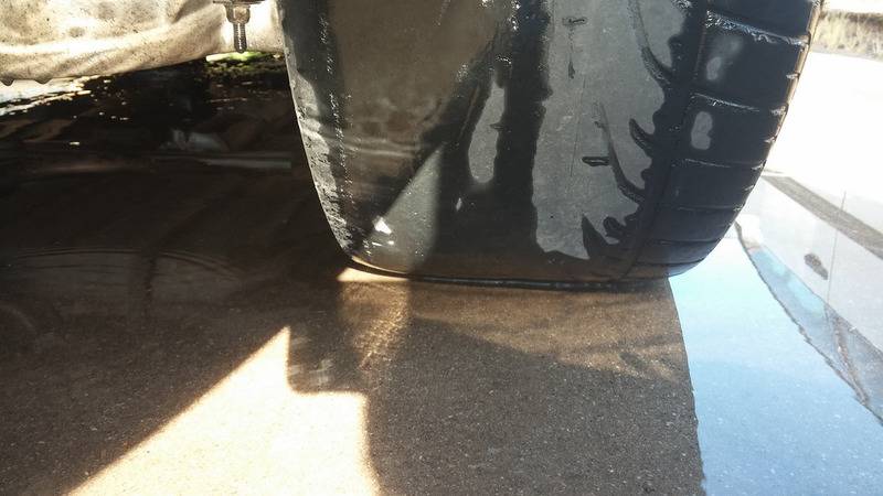

Last Nov I replaced the rear tires, last set had normal wear. Seems sometime over our long and very cold winter the bushings in the upper rear control arms went on vacation.... So I have a "spare" set on my F100, but they have the second design bushing in them that's junk so I'm looking for another set with good bushings in them.

So, why don't you want to just buy new bushings? You don't have to replace the arm. If you did, it would likely have worn out bushings in it too...
I had/have a good set on the F100. Those are now on the Mark. I'm looking at fabbing up some Delrin replacements for the arms I took off.
I've got some ideas that I've been thinking of for that eccentric bushing, that I might work out and try to include into my Delrin bushing kits, but it might be easier/better just to buy a set of the ones that still incorporate the original design. I had a set but I ended up installing them on a friend's car. I think they were the Raybestos Pro grade.
One just fell out, the other is in a bit better shape.

The passenger side one is destroyed. The drivers side is okay treadwise, and wearing fairly evenly across, but still wearing more on the inside. The fronts also wear much faster on the inside. I had an alignment done, but they waffled and wouldn't do the rear for some reason. The also had to be told about the eccentric and at first wouldn't touch the Cougar as it was lowered.

Just did my strut rod bushings. Then was told my passenger side tie rod was bent a little. (VERY cheap fix thank god) He then continued to tell me that I should not go more then 7 miles with the car like this because it will wear the tires out. Maybe the tie rods have something to do with it?
Daniel, the tie rods are the connection that steer your car. If they aren't set to spec, you could scrub a tire to bald in 100 miles. That's why you set them - roughly - with chalk and a string to make them close to square to drive to the front end shop after replacement. Just jack it up, spin each and use the chalk to make a line as close to center as possible, then measure front and back to make approximate square. My old Chevrolet ('56 210) called for 1/8 toe in and it was right on doing it this way. It is crude, but its better than being completely screwy before alignment. PM me if you need better explanation.
