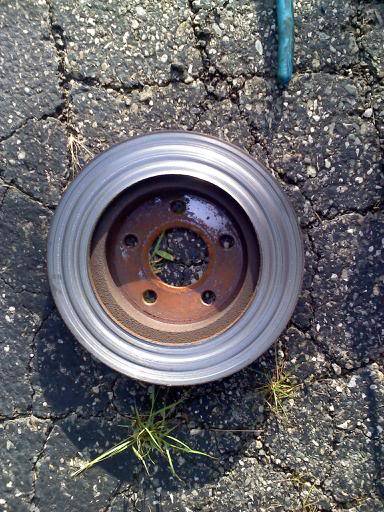

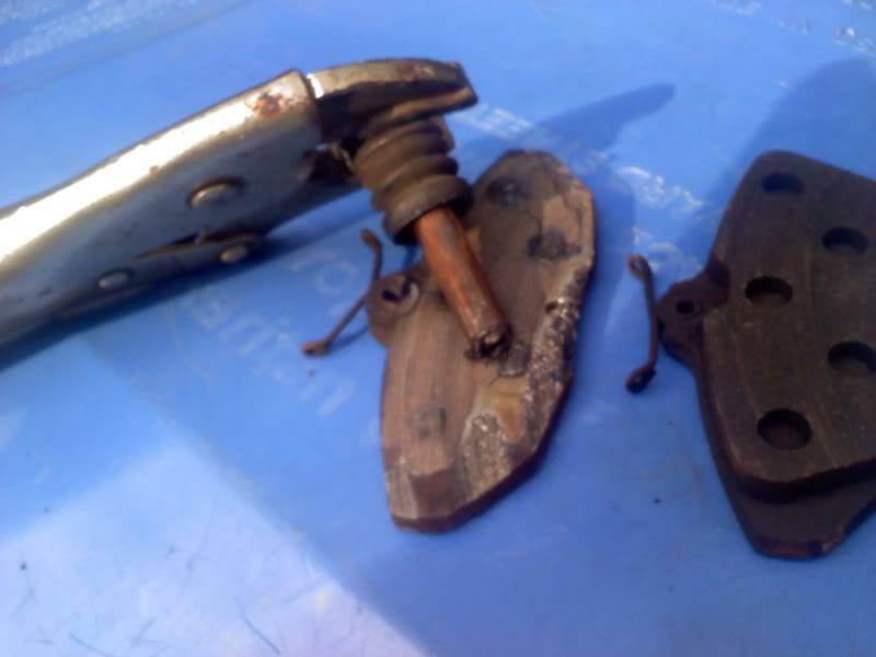

Have had it for a week or so now with the heat outside and it is still going pretty strong but now that I had the windows up I heard the dreaded rear rotor grind :mad:
God I hate the rear brake setup on these things!
It was fun beating the hell outta the pin after I Kroiled it with a pair of Vice grips on em. I got it out and fixed so I didn't have to buy a new setup at least :shifty:
Also note the wheel spinning in the Gif is the rotor with the bad pad...
That burnout in your sig will cause that kind of damage.....
I did them all the time in the 96 I sold to you. This one when I took the caliper off the one floating pin was seized from rust. Fixed it and have to take the other off and check it tomorrow to make sure it is nice and anti seized up so this don't happen again :rolleyes:

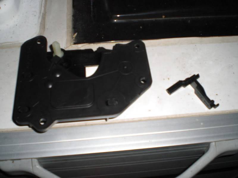

So I am guessing that the Blender Arm is stuck in the cold position and I actually have to replace it after all :(

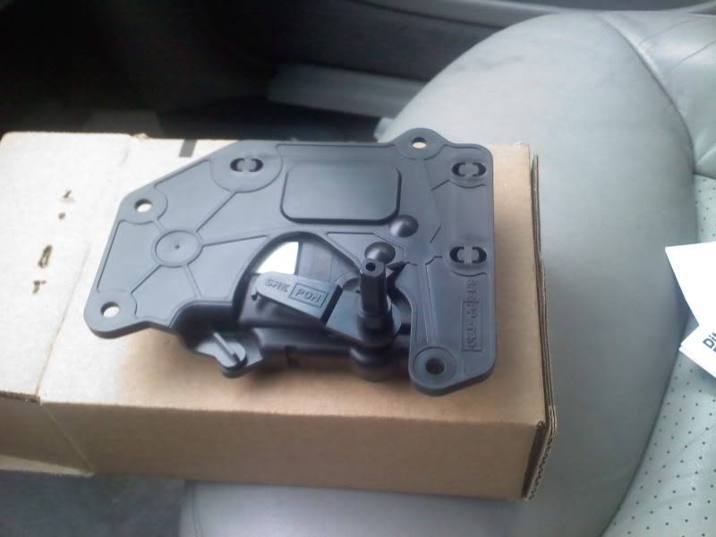

Ordered yesterday and come in today.
Now have to wait for it to stop raining so I can put it in. Garage is full of WRX and SL350 and I ain't bothering to pull either out :shifty:

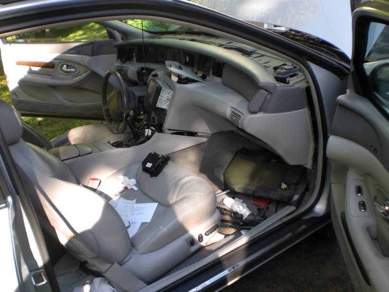

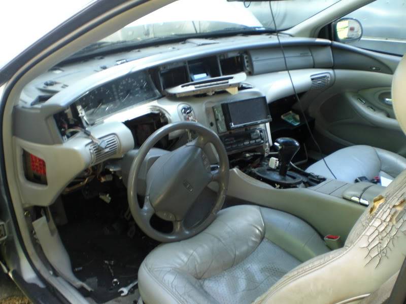

OK installed new blender arm assembly and yeah it's nice to have anything from heat to AC again BUT :shifty:
Took me about 5 and half hours to get it in and the car dash back together again. It seems that this it the second assembly this thing has had since it only had 3 bolts holding it in instead of 4.

So this was the nightmare I call my car and a simple fix...HA
And after the freakin 5 hours it took to get this piece out that was replaced once already! I hope the new piece is updated so I don't have to go through this again :mad:
Wow that drivers seat is beat up. The new blend doors are reinforced and should last. Mine has held up fine over the past year.
Yeah, but next time you'll be able to do it in 2 hours. :p Unfortunately, the "updated" actuator will eventually break too, so there will be a "next time" in its future. You're probably good for a couple of years though.
