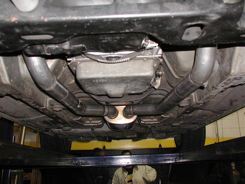

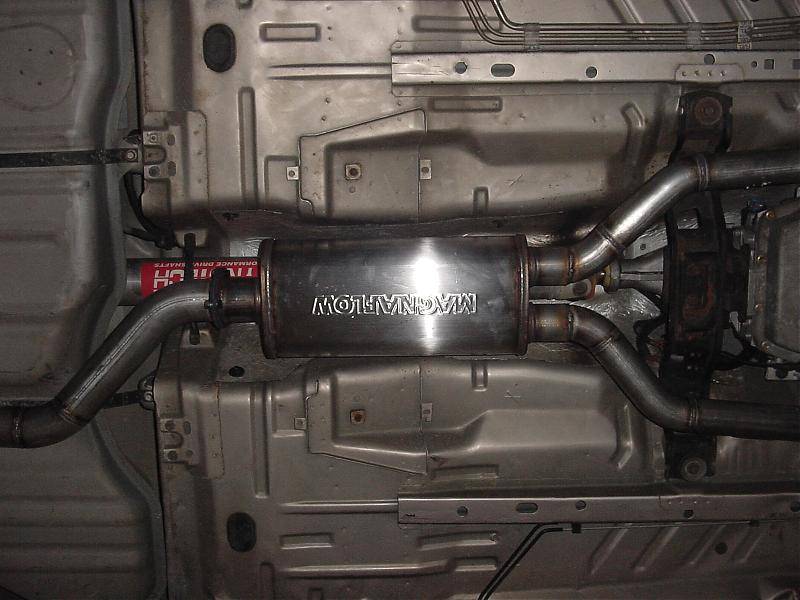

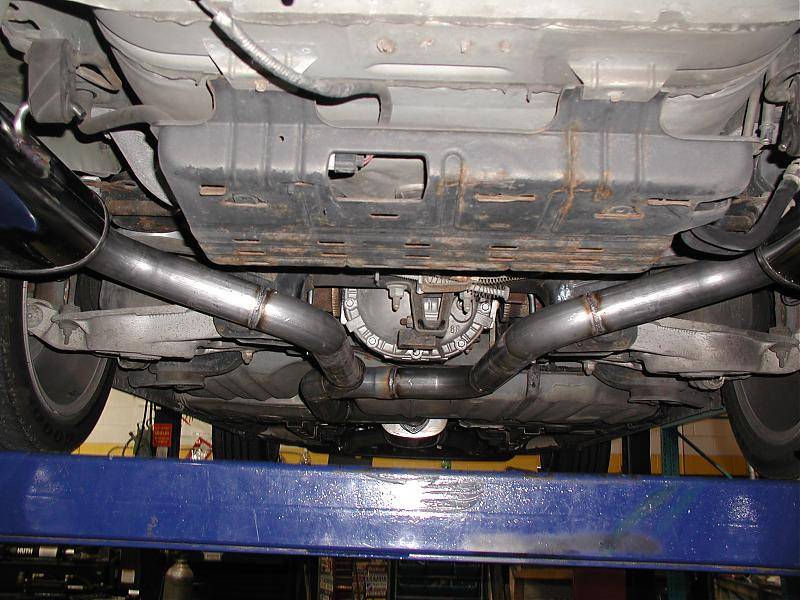

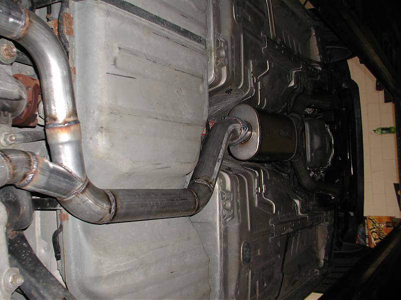

Looks ? it's all about doing it right. Check out this 2x2.5" into 3" single. It actually takes off from 03 cobra manifolds, no cats.
The setup is entirely drone free, and sounds like a c5 on steroids. Now that's a $800 actually worth the money. ;)
now thats what i am talking about. thanks man. what kind of mufflers in the rear? and do you have any sound clips by chance?
Thats an interesting set up. If its the case that a 2 into 1 system is better overall, then one could always just add a fake tip for a true dual look. Plus, a single pipe would be easier to exhaust wrap for heat retention.
That exhaust set up that m_maker posted is VERY clean! I think my favorite so far!
