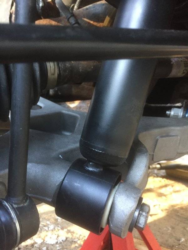

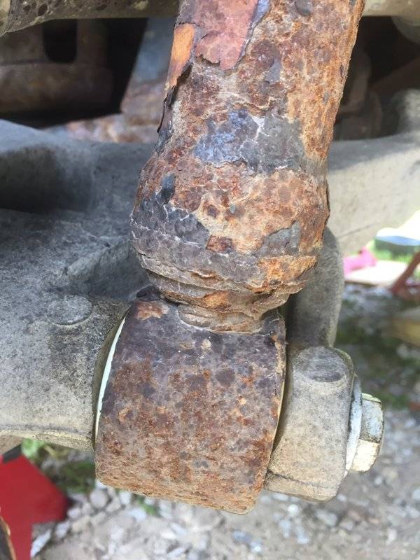

      Just for fun, here are a couple of pics of the old and new:
      Before installing the new shocks, I applied a couple coats of paint to that weld seam for some additional rust protection.

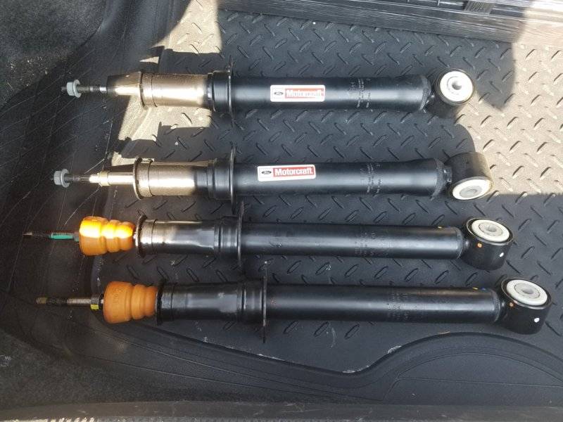

        I went with Used MotorCraft off Ebay and wasn't disappointed at all ...I was fortunate to pick up these brand new MotorCrafts this summer off of Craigslist ...the guy purchased them off Rockauto when they were having a closeout sale ...I'm putting them on my 2002 LSE when Spring hits 20190707_085253.jpg 20190707_085304.jpg
