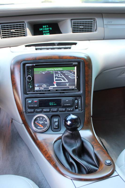

i just did a leather boot and shift knob on my car-

Im actually looking to paint the shifter know not wood grain
The Walnut Knob, which I have, is very fine and the wood is beautiful. The feel is very nice and I polish it with my hand every time I use it.
It's not wood grain it's solid wood mounted on a Mark VIII knob mechanism..
Purpony that setup looks great how did u get that know to work I've never taken the shifter apart before
