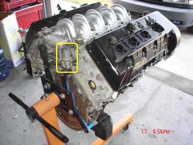

Remove cowl, remove throttle body, use a gear wrench...have fun
Here you go... Enjoy!....... or not! :(
Funny, I never removed the cowl on my 96. I simply removed the throttle body and used an offset wratchet wrench and a 1/4 ratchet. No problem.
