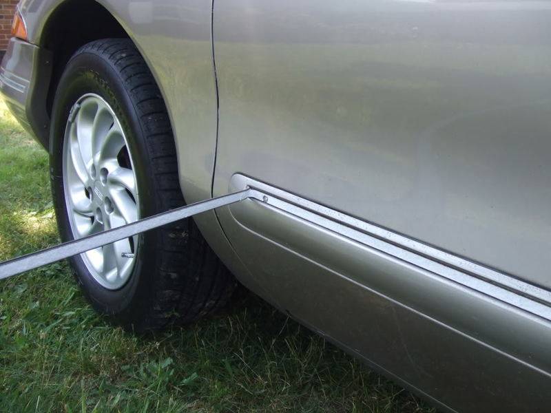

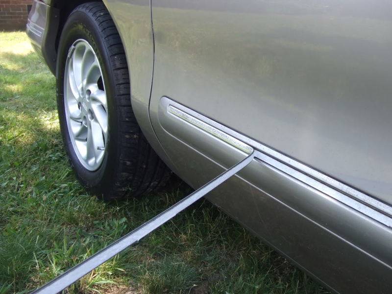

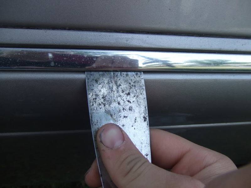

First get your self something thin like a puddy knife to pull up the old chrome strip. i recommend using blue painters tape or something to keep you from scratching your paint. Start at the bottom or top and work it free from the adhesive. Its best to start at either of the ends.
Then, simply pull off the old chrome. KEEP THE OLD CHROME. You need it to measure your new piece of chrome. when cutting old chrome always cut it a inch longer then you need it. its better to have a little extra then to wind up with a short piece and have to cut another one. (thats was she said

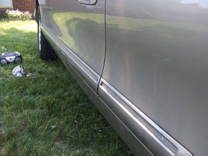

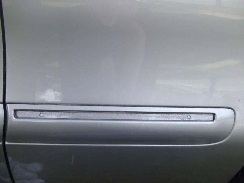

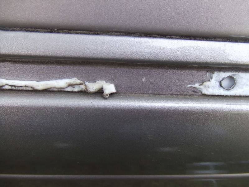

Then starts the fun, start pealing off all the old adhesive. I used the puddy knife to gently push the adhesive to a small strip of it. Just made it easier for me.
then I used my thumb to get the rest off. You could used a plastic flat head screw driver. BUT BE CAREFUL.
you need to remove 100% of it. Otherwise it might not adhere right, or wont last as long.

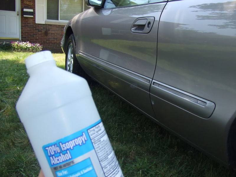

then after its all gone, use Isopropyl alcohol. This will get off what ever adhesive is still there that you cant see, and all the residue that was left.

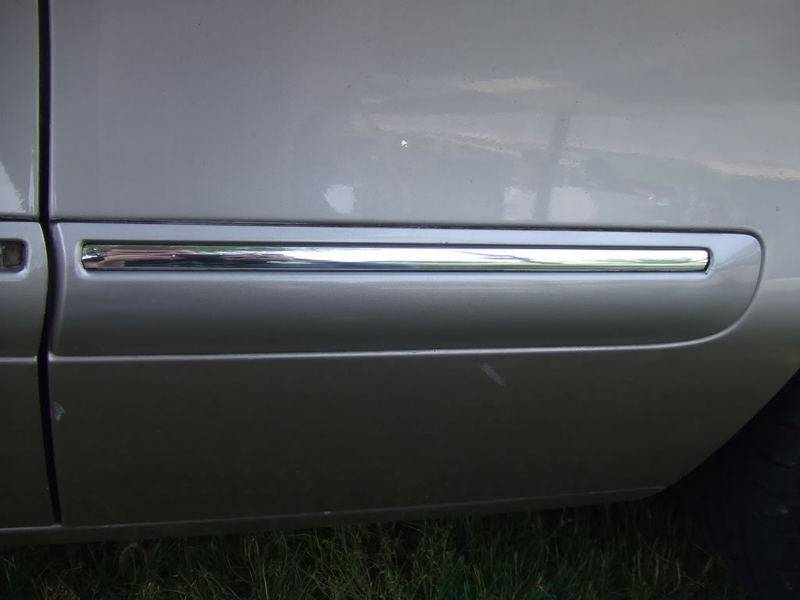

then starting at one end, start putting on your new chrome. I started at the back and worked my way forward. Make sure you pull the chrome tight so it doesn’t look rippled when you look down the car.

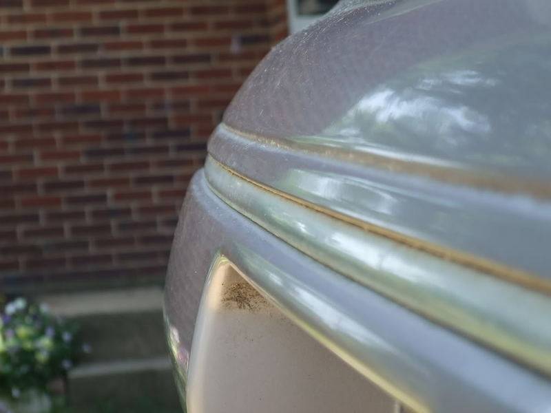

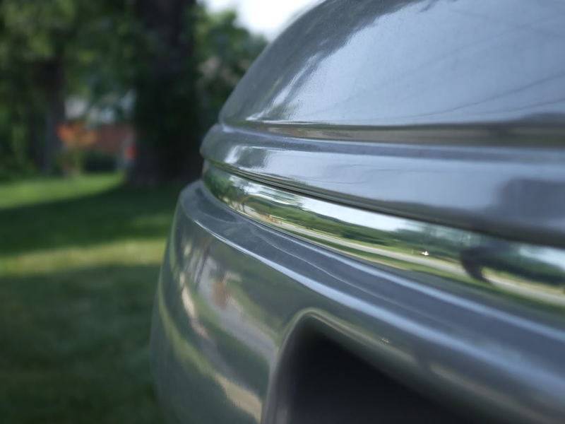

^ in this photo the chrome is strait, its just the reflection of the bush in the back round covering more of the sidewalk. Its strait.

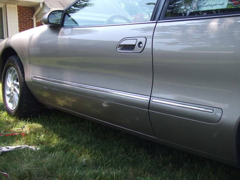

Here’s before (well this is on my other Mk)
Here’s after.
