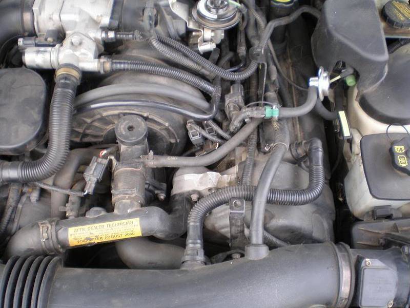

Clean your engine!
You think that's bad? Here's mine right now. I haven't even had the vehicle a year yet. The previous owner didn't clean it at all I don't think. It's the first on my lisst for spring cleaning, although I'm still trying to figure out the best way to go about it.
