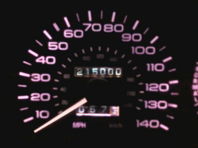

I hope to get a least 100k more miles...with my new car! I snapped this photo on the way home from Columbia to Charlotte!:D

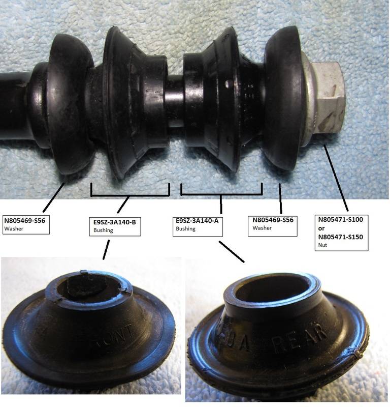

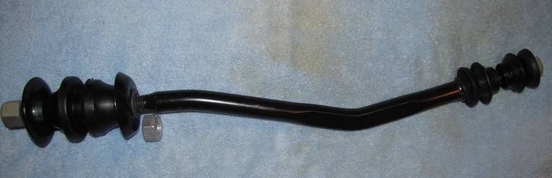

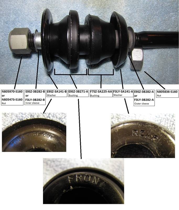

I put these pics together a while back. Hopefully they'll come in handy to someone. I didn't install the inner nut on the front bushings because it's a nylock nut and I didn't feel like cranking it on just for a picture.
Aside from the bushings themselves, most of the parts are obsolete but may still be found except the sleeves. I was able to get the washers from Tousley Ford. Green Sales has most of the parts except the nut for the control arm end. That one is not to be found anywhere.
I did not purchase the tie rod ends, nor did we replace strut rod bushings (post #17) of this thread. Jay can correct me if I am wrong. In August of this year the Ford dealership replaced the front and rear strut or radial arm bushings. The front ones are blue in color and presumably from Moog. The rear ones are black in color. I made the decision to keep those and watch them. Especially the front ones. I don't drive the car that hard so I will watch the front SRB's. I have seen some pictures on this forum that are quite disturbing with respect to those Moog front SRBs! We didn't have to remove the inner bumper guard to get at the d side uca bolt head. On the p side we had a bit of a problem with removing the sway bar end link because of the brake line being in the way. But Jay removed the caliper (so he/we did a brake pad rotor inspection too. ;)). On the D side we removed the sway bar end link earlier in the procedure (I think) so that we didn't have the brake line problem. We removed the flag on the d side rear uca bolt and that made its installation easier. Note I use the term "we" here rather loosely because Jay had both the knowledge, tools and expertise. It would have taken me a lot longer and beside working with an expert is more fun. I have always been rather reluctant to use additives (e.g., STP etc). But the Sea Foam, I have too admit, was fun! Cleaned out something with all that smoke! Looking forward to getting my "eyes" (headlamps) rebuilt and working on the paint and exterior trim. Jays 98 Mk8 is really done nicely and of course I drove home with a head full of ideas for mine. 18 inch wheels...ford focus brakes...the cheap ones from europe ;))
