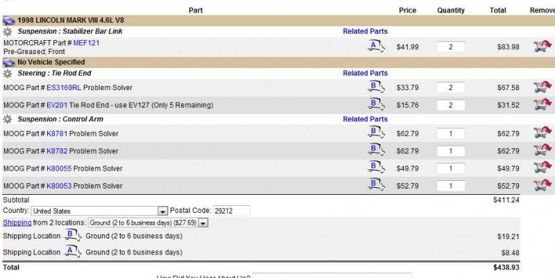

Scott (achesonm8), here's what I PM'd you yesterday. Best prices were from RockAuto. I priced the same components on Amazon, and they ended up being about $50 more, even though Amazon had free shipping...
MOOG K8781 $62.79 (Mark VIII UCA)
MOOG K8782 $62.79 (Mark VIII UCA)
MOOG K80055 $49.79 (T-Bird LCA)
MOOG K80053 $52.79 (T-Bird LCA)
MOTORCRAFT MEF121 $41.99 x2 (Mark VIII sway bar end links)
I forgot about the tie rods, so here's what I recommend for those...
MOOG EV127 $12.20 x2 *OR* MOOG EV201 $15.76 x2 (Mark VIII inner tie rods)
Moog ES3169RL $33.79
I'll talk to you about the Strut Rod Bushings when I give you a call later today. We may be able to get a set of OEM Motorcraft SRB's for you, sleeves and all.
The picture below is a screenshot from RockAuto.com. Give me your email address, and I can have them email you the shopping cart and save you some time.
