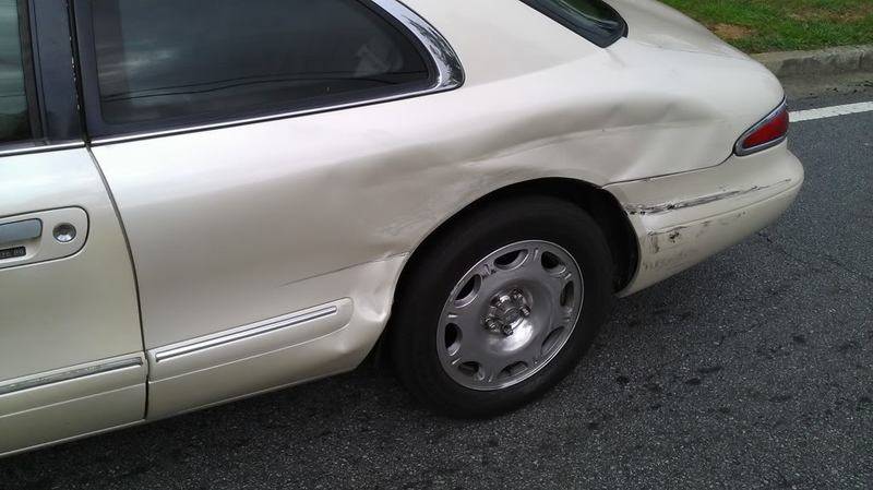

well folks. my car was involved in a Hit and run. the damage isnt a joke, and unfortunately my insurance doesnt cover this because the other driver cant be found. i got an estimate of about 1000$ to fix and repaint the whole side of the car ( thankfully be rid of the multi color paint).plus i dont like the color so i would have to change the entire color of the car to black. so my question is what do you guys think i should do with the car.pour money into it, or get something thats in better shape. its a 98 base.
NEW damage

The damage don't look that bad. What worries me is the damage underneath. You need to pull off the rear wheel, and check the half shaft, upper and lower control arms. Make sure there's no damage there. From the pics, you'll need a new bumper.

id get a few more estiments first for the damage i see a 1000 is not enough to do a good job. i wouldnt even bother fixing it id replace it with a new quarter panel.

From the pictures I would say no way they are fixing that the right way for $1000. If it was just a dent and that large I'd want to hang an entire quarter on that side, looking at the door gap something is a little off. Side damage on a unibody car = idk!

Yeah $1000 to fix that..it will end up turning out like sh*t, they would probably pull the dents out and lather bondo over he whole 1/4 panel, it'll be wavier than a washboard and guaranteed the paint won't match worth a sh*t, it'll end up looking worse than the mismatched paint that's already on there.how much did you buy it for? I would just try and sell the car for $1000-1500 as just a driver and look for something else. If you wanted a full paint job done right you would spend thousands..not worth it..
I have a 97 parts car with a good rear quarter panel and rear bumper. Someone I met once needed the same and the man who does my brothers body work said he would replace the rear quarter and paint it for 1,500. And he would fix it right. And his was a little worse.

If that's not your cup of tea then sell it to someone willing to fix it & get yourself another one. The damage isn't big at all. You just have to want to do it.

thats easily a $3000 repair, if you can find a lkq rear cover and quarter panel and then the blends(3 stage paint) on all the adjacent panels. hopefully no suspension damage, although that is the easier to fix. i would check the suspension and drive it the way it is.
I think ill just drive it for now until somebody wants to buy it. I did have to replace the upper control arm tho. It was bent
