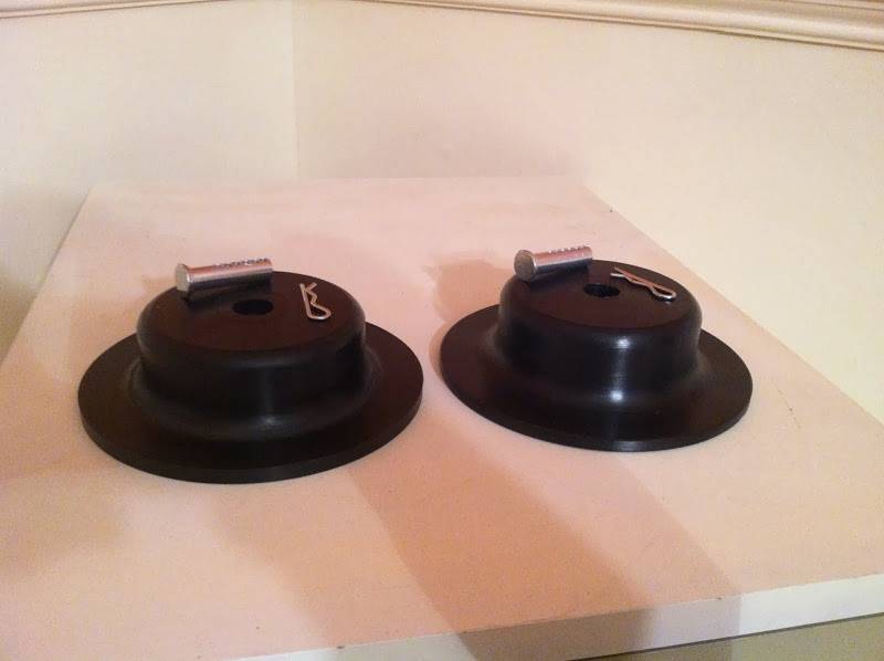

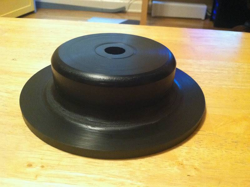

Well, I'm pretty sure I got these spring perches figured out. I did a bunch of research and came up with some good specs, and this is how they've turned out.
So far, I've only made a set of uppers. These really do take quite a lot of work. UHMW is not very easy to machine either. There's quite a steep learning curve to get a nice finish on it. It's completely different than the stainless steel and aluminum that I'm used to turning.
I can totally understand Doug's pricing on these. If I'm going to make and sell these in the future, they'll be the same as what Doug charged, $150 shipped for just the uppers. Of course, the Prothane isolators will need to be purchased as well. I found/bought a set for about $30, that should be here early next week.
Anyway, since I don't need these for myself, and frankly never plan to ever need them (Air for life! lol), I'll offer a discount to anyone who wants to try out this first set and offer me any feedback on them. If they flat out don't work, just return them unharmed, and I'll refund you the money.
I'll offer up the set of upper spring perches and a set of Prothane isolators for $150. So basically, you'll be getting the isolators for free.
That looks good. Pretty similar to the ones I made. I actually didn't use a lathe. I think UHMW might be easier to mill than turn. I started with a rectangular piece which is why I just milled it as an island and then cut the back off in soft jaws. How will those work with the top of the spring? The spring coils all the way to the top, right? Is the intend to reuse the rubber cap on both ends? I did that but then that makes the ID smaller because the perch has to fit into the rubber.
looks great Jay, nice work...what holds the large pin in place while youre' sliding the cotter pin through the hole?..tight squeeze
looks great Jay, nice work...what hold the large pin in place while youre' sliding the cotter pin through the hole?..tight squeeze
Thanks!
Basically, you would need to install these first, before putting the spring in there. That way, it would essentially be just like installing the spring into a Thunderbird.
The ones in this thread look much better than what Arnott, AAS, or Strutmasters sells (or don't include all together). I bought the lower perches that SCP sells and will use the uppers that come with the spring conversion.
Those look identical to the ones I bought from Doug last year..the lowers are the same as the uppers but have a small "nipple" on the bottom so they can rest in the hole on the lower control arm keeping them centered (see pic). Have you tried using aluminum instead of the delrin material or whatever its called? Seems like it would be an easier material to get..and I'm sure the weight difference is minimal.
