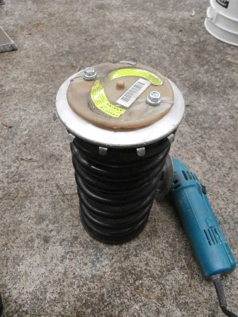

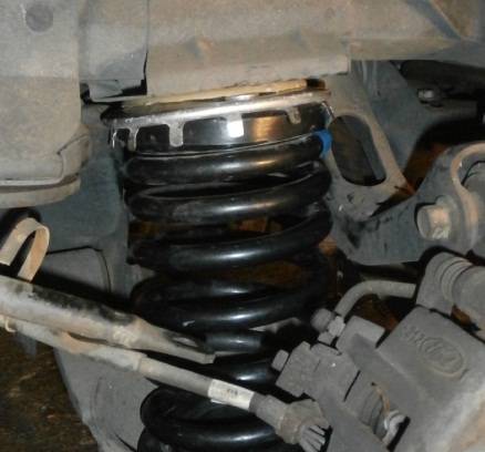

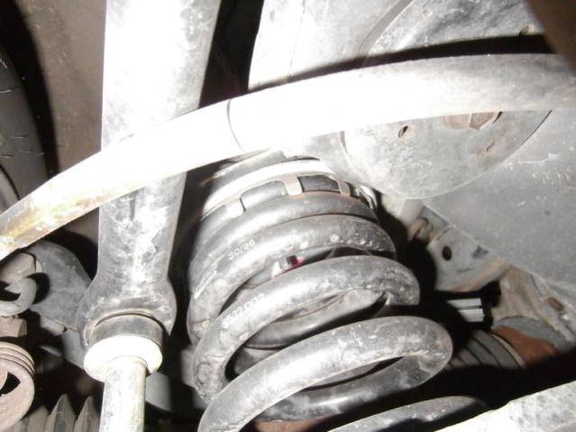

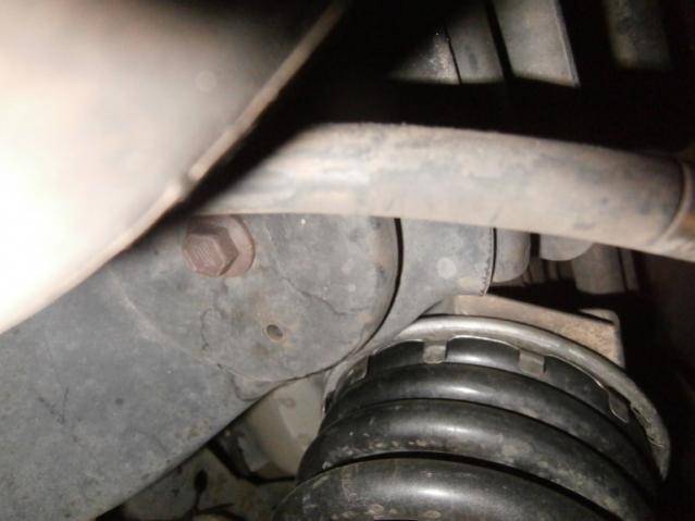

You're assuming linear compression, that isn't the case here. The spring perches see horizontal force as the spring is compressed. The factory airbags did not impose this force on the airbag plastic top and bottom endcaps.fwiw, I removed the isolator from the coil top, so the fins (hammered in place) do fit the coil tighter without it.
correct my physical understanding where appropriate:
for there to be movement of the spring-top, there would need to be minimal load and a sudden stop or turn. That rules out sudden accelerations or braking. A sudden impact against something very massive (without braking) might make them move?
keep in mind, oem is just 3 little plastic nipples

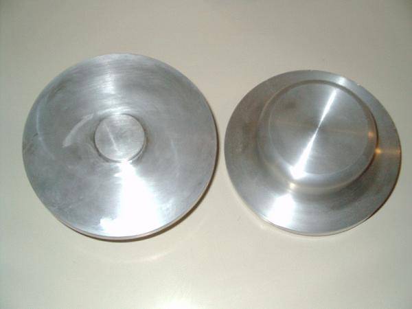

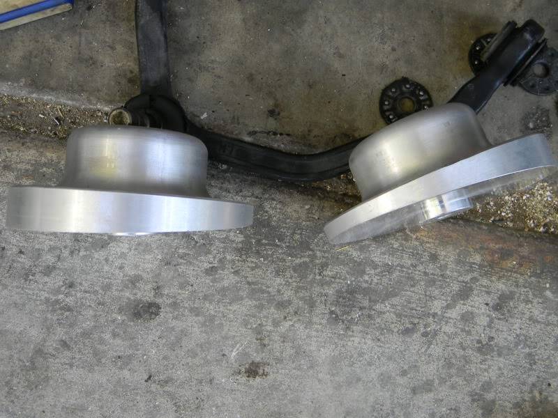

If you choose to rely on that method to locate your springs, so be it. I wouldn't go recommending it to others as a viable and safe method though.
If you're paying that much for perches, you're getting ripped off.I'd much rather re-do my interior, get LSC housings, get dual exhaust or get better wheels than spend $3-400 on pretty perches.
Bingo.Why is it so hard to understand the concept of " just because it works does not mean it is right"?
