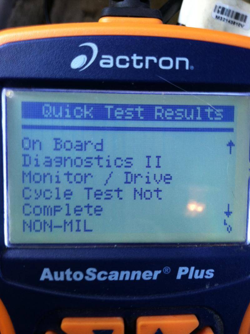

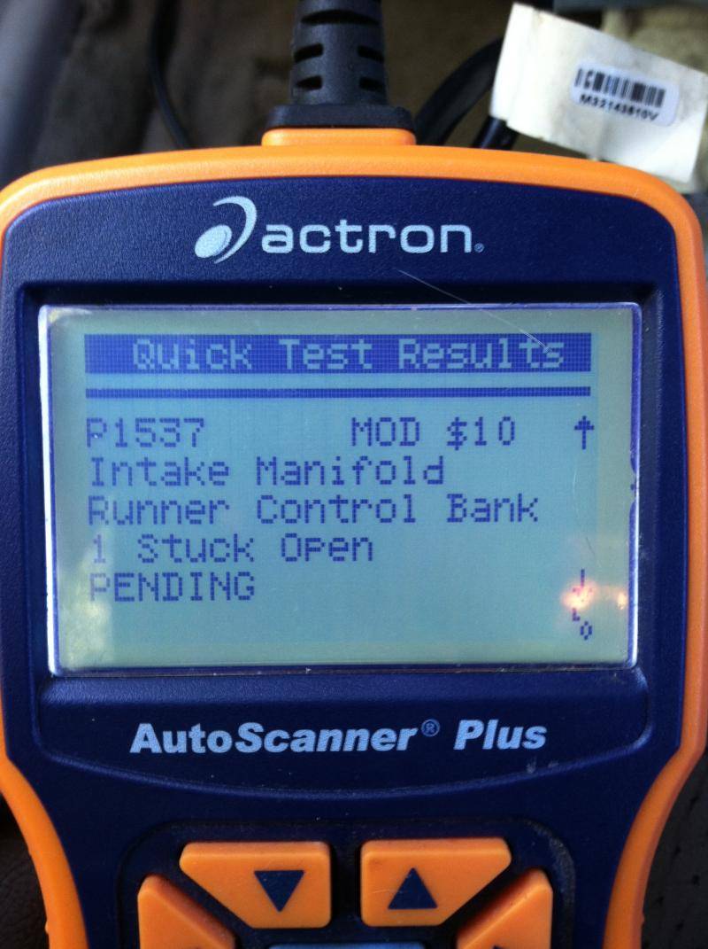

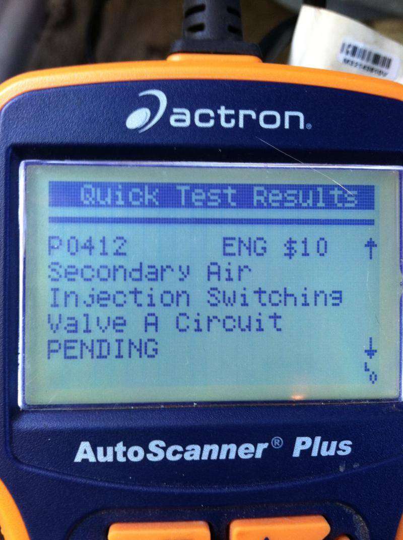

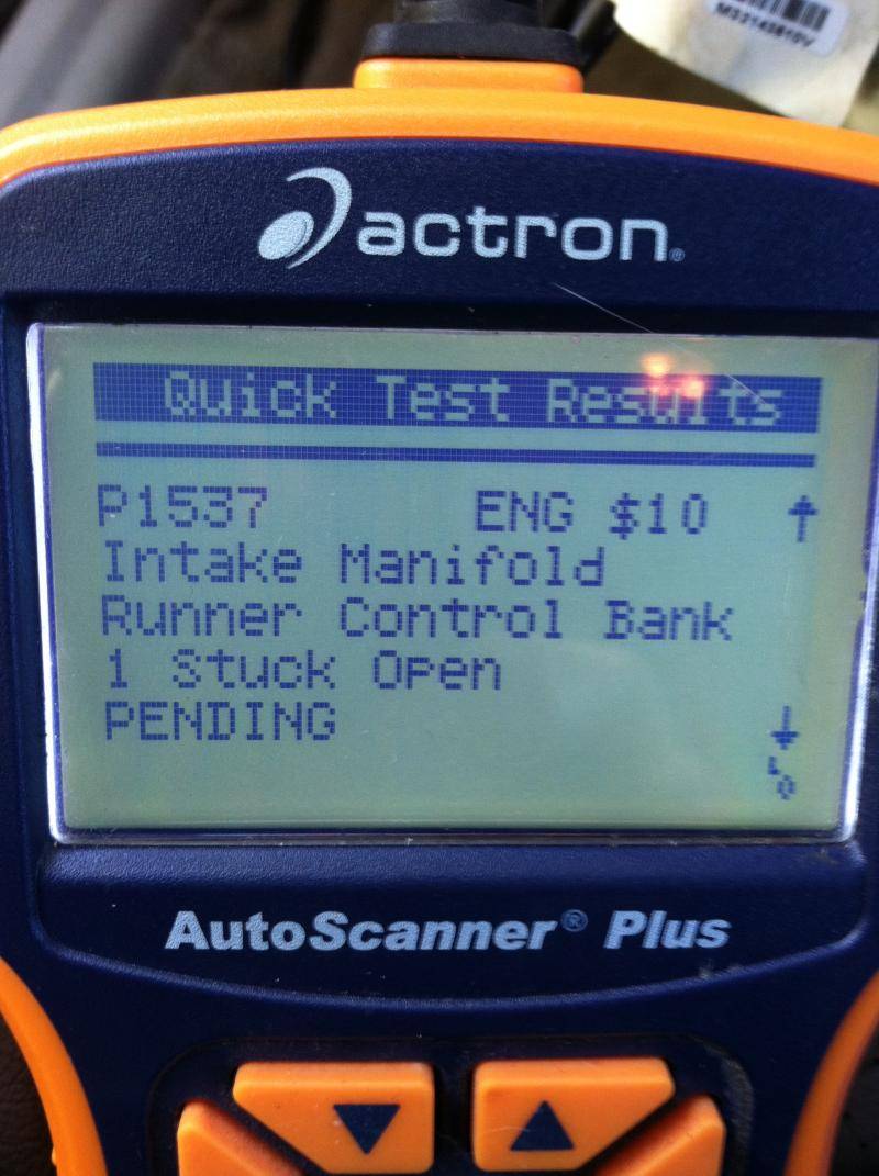

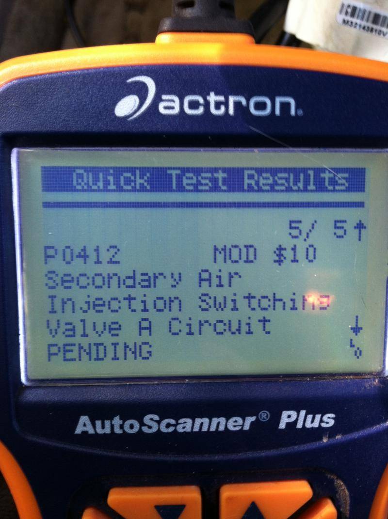

Thanks for the info soduka. Here are the codes I just pulled:
new diagnos pics 022.jpgnew diagnos pics 023.jpgnew diagnos pics 024.jpgnew diagnos pics 025.jpgnew diagnos pics 026.jpgnew diagnos pics 027.jpg
Any insight is greatly appreciated. I'm going to make another thread so someone else can use the info too, thanks again for any help.

Hey Greg. I made it back from Seattle. Code 1537 is likely caused by the bank 1 intake manifold runner control actuator going bad. They use vacuum to hold the runner closed at low rpm. The vacuum pod has likely failed and as Chris said very hard to find 1 year only part. We will have to do some checking before we condemn the actuator though. I've sold all of the ones I had, and now have a 96 that I think needs one also. The p0412 code is most likely caused by a seized air injection pump. Check the 30 amp thermactor fuse in the underhood fuse block as well as the 10 amp eam fuse in the same block. See if either one is blown, and we'll go from there.
Hey Rog, the #2 fuse 30 AMP was blown, it was the only one. I'm going to go to the pick and pulls and hope I win the lottery:)
