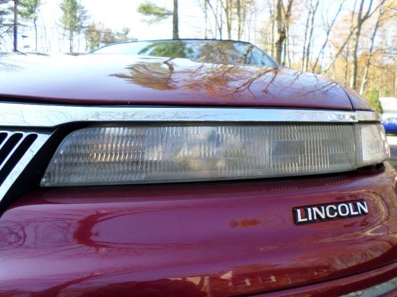

My 1993 lens which I have never polished yet.

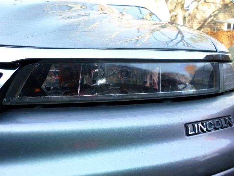

Factory HIDs in my 1995.

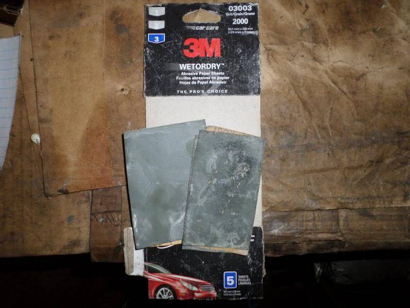

Here is the wet/dry sand paper that can be bought at Autozone

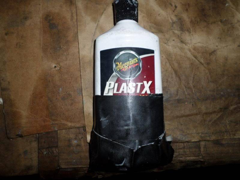

PlastX

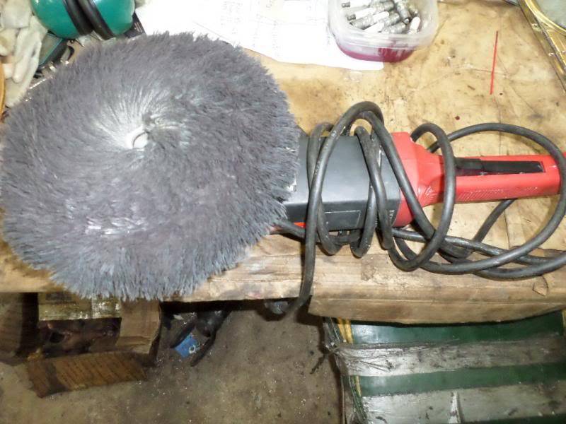

Buffer and go to town
holy scatter brains i love the hid lenses

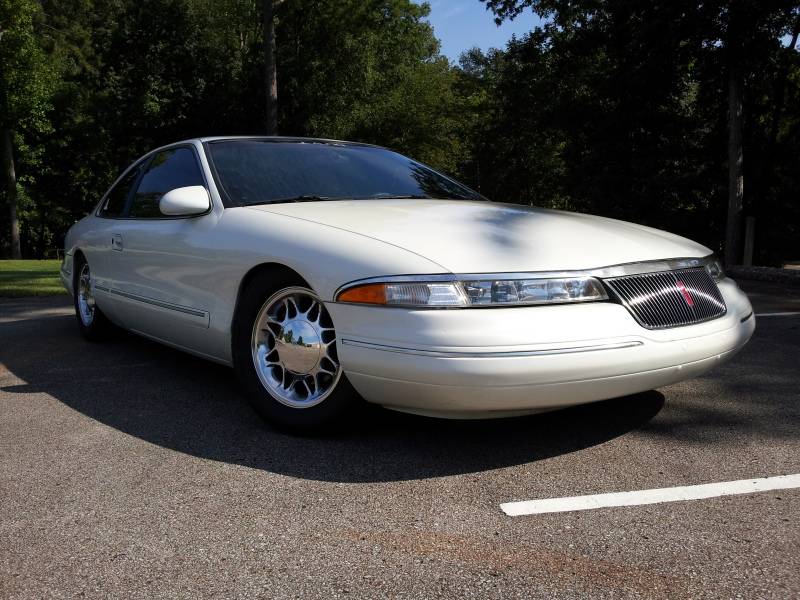

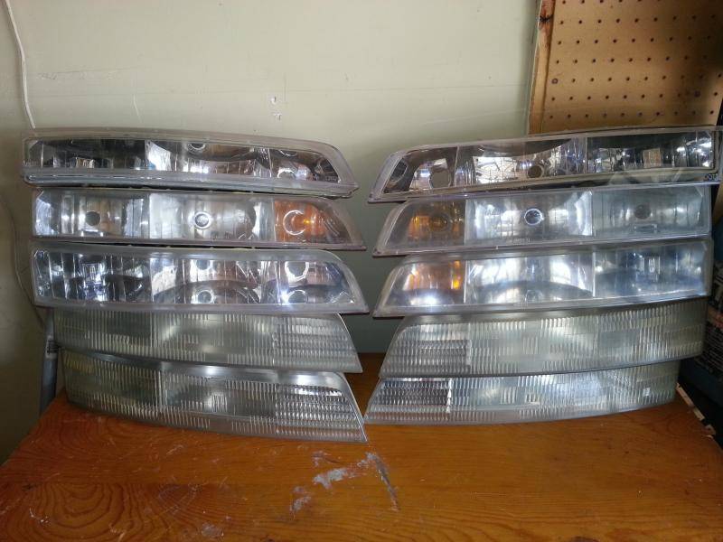

I cut the lens off, re-chromed the inside, glued back together and sealed with silicone and went with 6000k hid's. They are super bright and white! I still have to polish them, (dam I'll get to that one day)! I have no problems seeing at night anymore!:cool:
I already have them promised to someone on here if I ever do sell them, that is if he has the cash at the time. I haven't decided yet if I'm selling because I kinda like them too. Those housings are on in the sig pic below. I think I have a slightly different angle pic that was taken in the same spot.

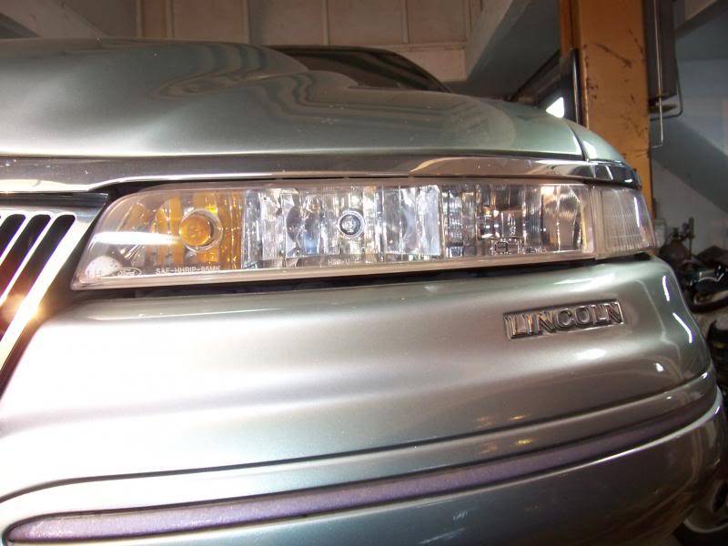

How Marks should have came factory... brought some new life back into the headlights! Cleaner look too!
