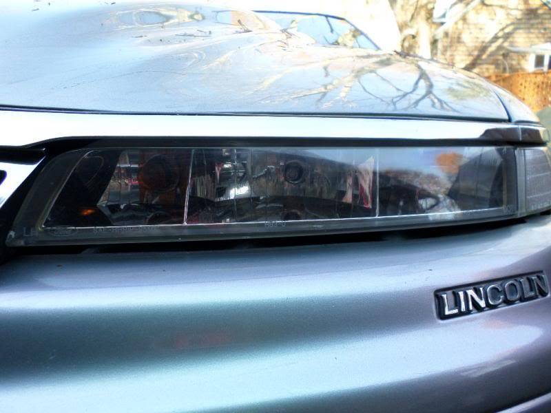

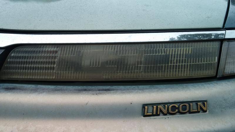

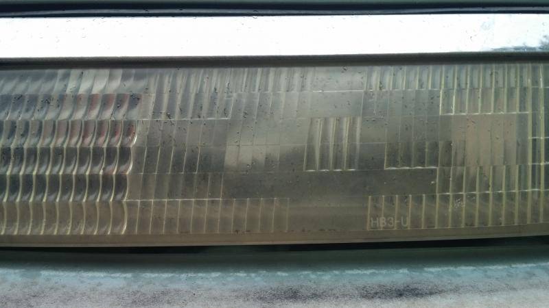

Here's what mine look like (how bad do they look? This is the first Mark Viii I've personally ever seen):
I found a "nice" set on ebay but they want $199 for the pair. I can't stomach spending $199 on a pair that will do the same thing eventually.

Yours look pretty good. Brighter bulbs will definitely help. You can use some silverstars or something similar, but honestly you will be wasting your money. You need to buy a HID kit. they will be far superior to anything over the counter at the parts store. check out www.ddmtuning.com

Your lenses don't look even "ok" to me. It's no surprise that none of the light is reaching the pavement. Go grab a headlight restoration kit at the parts store (I'm partial to Meguiar's) and see what difference $20 can make.

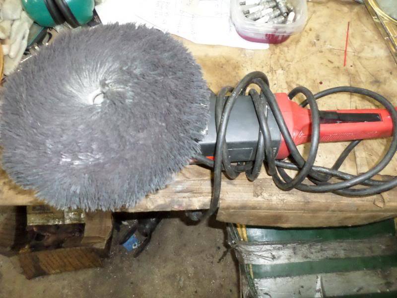

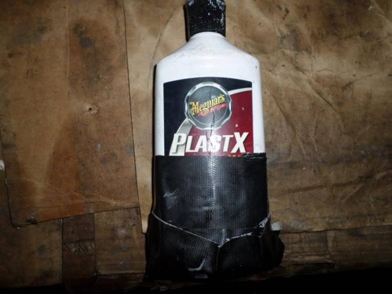

His lens look "ok" to me to. Not great but ok. I don't buy any kit. I buy 2000 and 1000 grit sand paper and bottle of "Plastic X?" headlight polish. I sand the lights with 1000 and soapy water couple times then sand with 2000 and soapy water couple times. Clean off between sandings. Then I take my car buffer and apply Plastic X and buff away for couple minutes. They look brand freakin new after you do this.

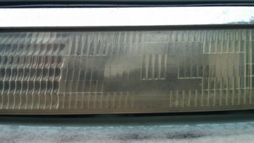

My 1993 lens which I have never polished yet.

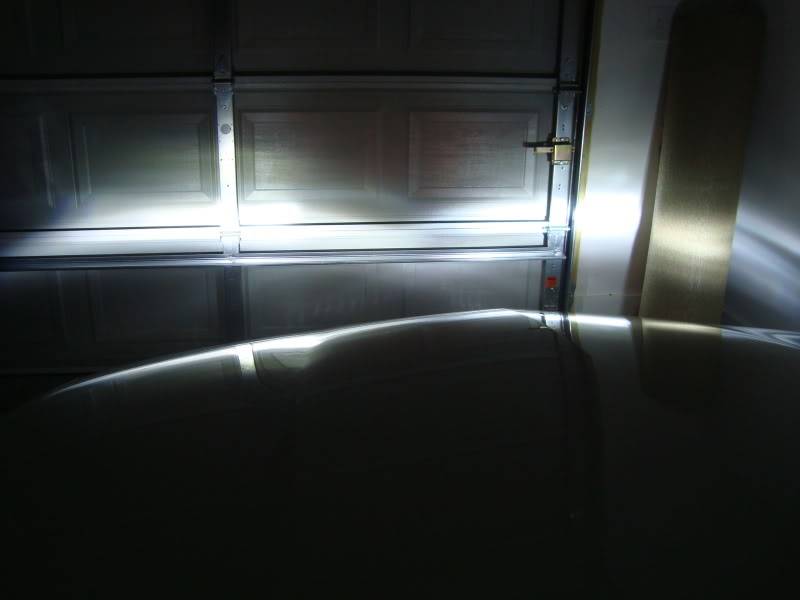

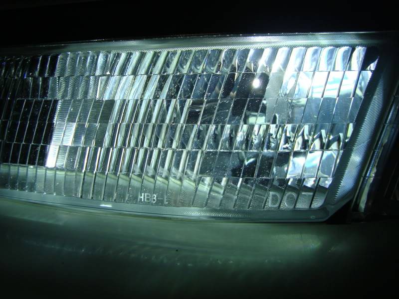

Factory HIDs in my 1995.
Here is the wet/dry sand paper that can be bought at Autozone
PlastX
Buffer and go to town
they need to be polished at a minimum.
and that might be enough IF the chrome is still good. but if the chrome is gone, it doesn't matter what bulb you put in there.

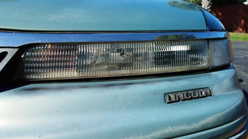

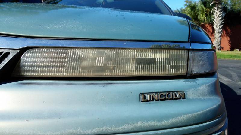

When I first got the car, I bought some stuff I had recommended to me by a few guys at work called "Uncle Pooters", sold on eBay. It helped, because they were worse then the picture showed before.....but the Meguiar's was a whole different ball game!

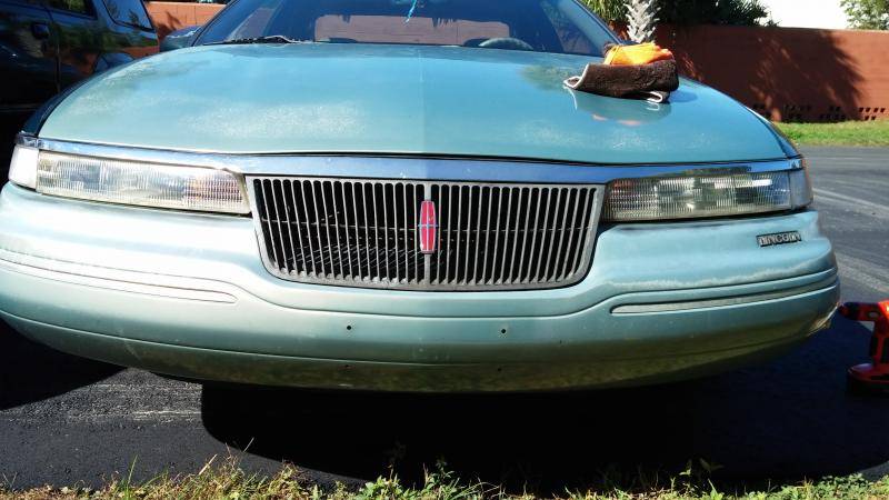

Check out the before and afters! They look almost new (they look a little foggy but after everything dried they look crisp).
Now how can I tell about the chrome inside, if it's in good shape or not?
Looks good! From the pics it appears the chrome inside is not bad.

VERY nice improvement! Told ya that kit was the ticket! Old halogen bulbs get more yellow and dimmer as they age so you're still not getting 100% output. I've used DDM HIDs in a number of cars all with excellent results. In fact, there's a kit on the way for my Continental right now.
