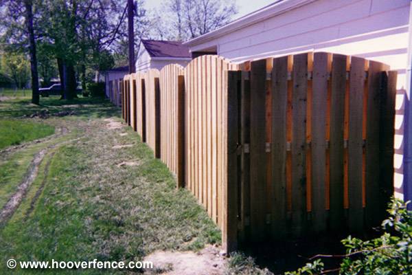

use pressure treated 4x4's for posts at home depot, get a post hole digger, and use a bag of quickcrete on each post, that stuff is awesome you can dump the bag in the hole dry, take your hose and dump water in ontop of the dry mix, use a thin stick and poke through the mix a few times, set your post in it and fill over with dirt to hold the post in place, dries fast. i'd buy the sections of fence from home depot you just stand up and nail to your posts. i like the looks of shadow box fence.
Cool, maybe I'll just give the good 'ole HD a try. I never thought about doing a shadow fence - that would certainly help with eliminating gaps between pieces - only thing is, means using more wood, plus may not look as elegant as a simple 'slat to slat' fence.

which side of the fence do you want to see? the flat side or the runners? the flat side obviously looks better but the runners are easier to climb over.

Shadowbox is nice, it lets the wind thru.
But it is a total PITA when it time to stain, just ask me how I know.
only if you do it by hand!!!!! best and fastest way to stain it is a wagner airless power sprayer, dump the stain in and shoot!!
