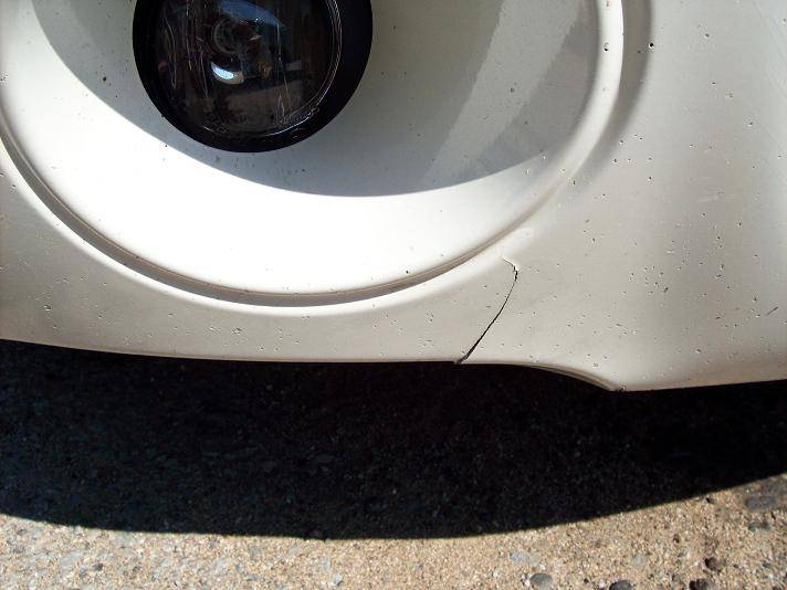

Practically the only flaw with this car when I bought it in April is that the passenger side bumper has a crack in it. Looks like the previous owner smashed into something. Fog light is off center too. But the bumper has a nice crack in it that runs along the bottom, is this fixable at all? I tried searching for bumper cracks without much luck...

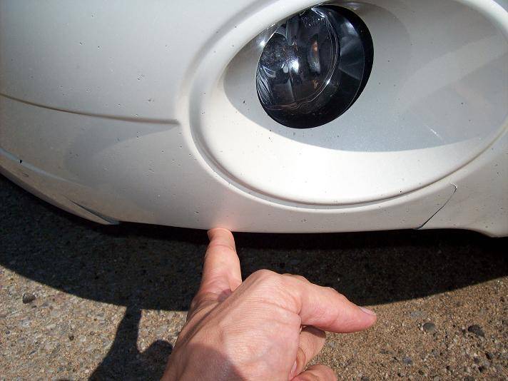

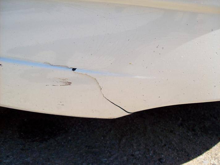

Alrighty, sorry it took so long, busy day! Here are a few picks:

I would epoxy / JB weld from the back and touch up paint the front... Cheap and easy
^^^^ x2
I wouldn't use epoxy though, it will crack and break off within a month or two with the bumper contracting and expanding.
I have a crack on my front bumper as well - about 4" long. I used liquid nails:pL 400 and some touch up paint. It's been holding up for about 6 months now. You can't even tell there is a crack there, unless you know it's there.
Holy batman! What happened to your bumper? Did you drive behind a dump truck dumping gravel?
Do what 05 LS8 did or you can have a shop sonic weld it, that's fancy talk for plastic weld.
Nice, thanks fellas! Glad to know it's not so bad. Any thoughts on cost? And all the little rock chips were there when I bought it... Also have to understand that those pics are pretty close up! Which begs the question: Is it possible to fill those in somehow? :D
