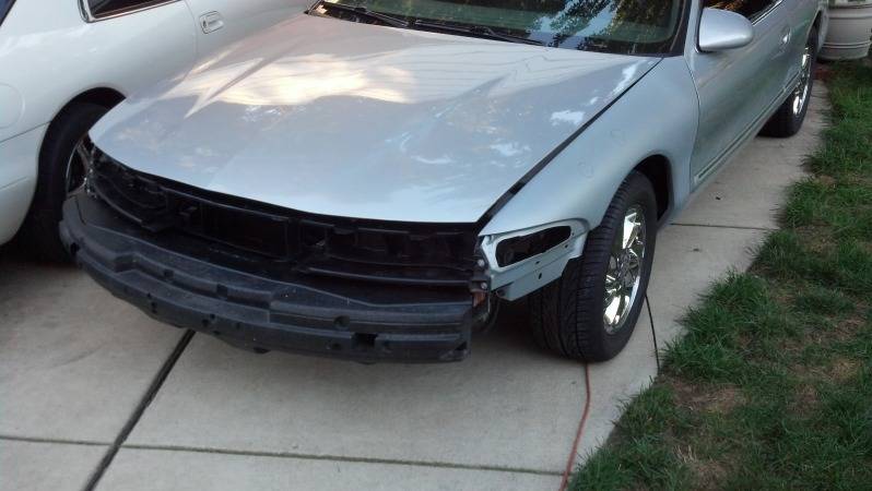

ok i got the broken header panel out today and found that my headlights are cracked:(, anyone got a good set of halogens?? or did someone(on the forums here) buy the set diesel dan sold and are keeping them for spares and are willing to part with them?? the bumper cover was able to be saved:D but now im on the search for the actual steel bumper as mine is a bit twisted.

The most I'm going to get is 500$ due to Michigan State, and and I have everything I need parts wise except headlights

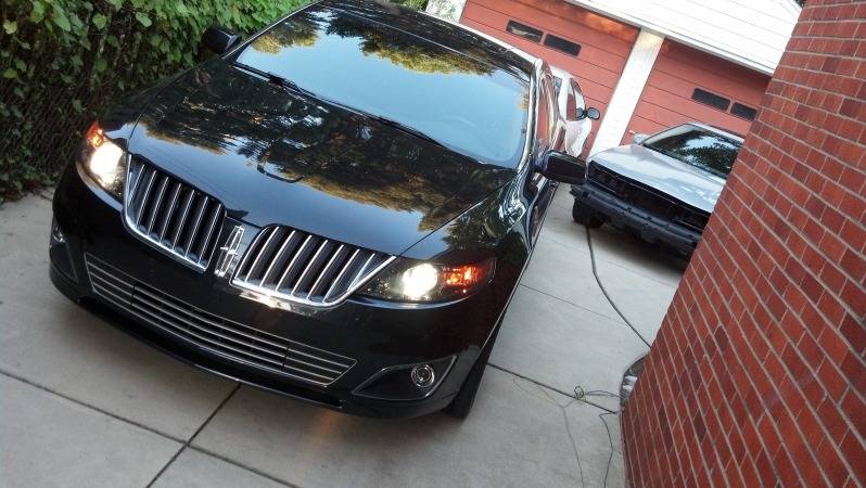

got my new lights today!:D
but the high beam bulb area has some water spots on the chrome any way to clean the spots out?
And yes the housings are tinted:D
Depends if the water spots are through the chrome or just dirt on the surface, take a garden hose and a small amount of car wash soap and fill up the whole light and just shake it around..don't try wiping the chrome with anything as it is seriously brittle and can be scratched or worn off easily, just rinse it out and shake the water out as best as you can and take an air hose to get the rest out..and take that tint off, the clearer the lenses the better you'll be able to see at night.
Thanks for the tip i will try it, i plan on taking tint off eventually as it is chipped in a few spots on the edges
